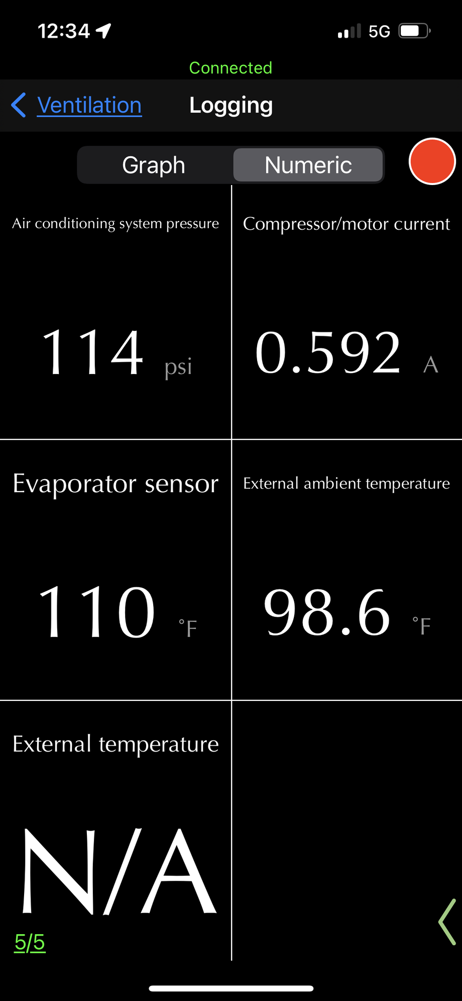

If the pressure just evens out, then your compressor isn’t compressing.
The compressor current at 0.8 amps is max demand.
Here’s live data from mine today while warming up. It’s hot here in Texas today!

Thanks P-bod.
Good to know, sucks to have.
Here are values from mine today.
