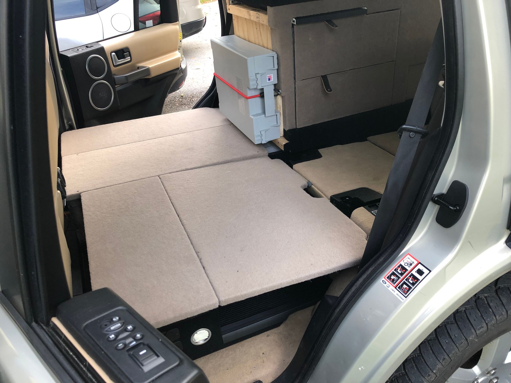

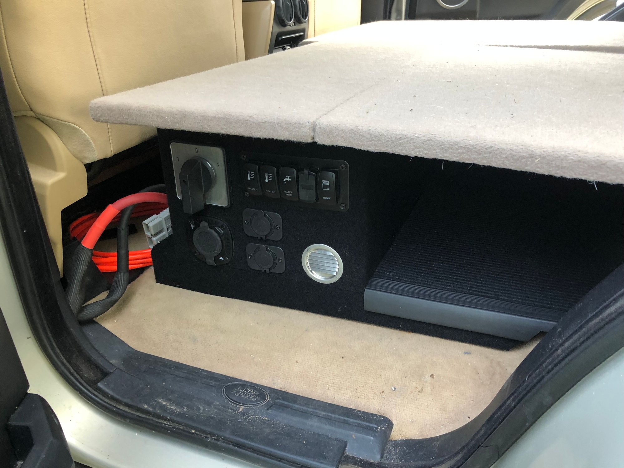

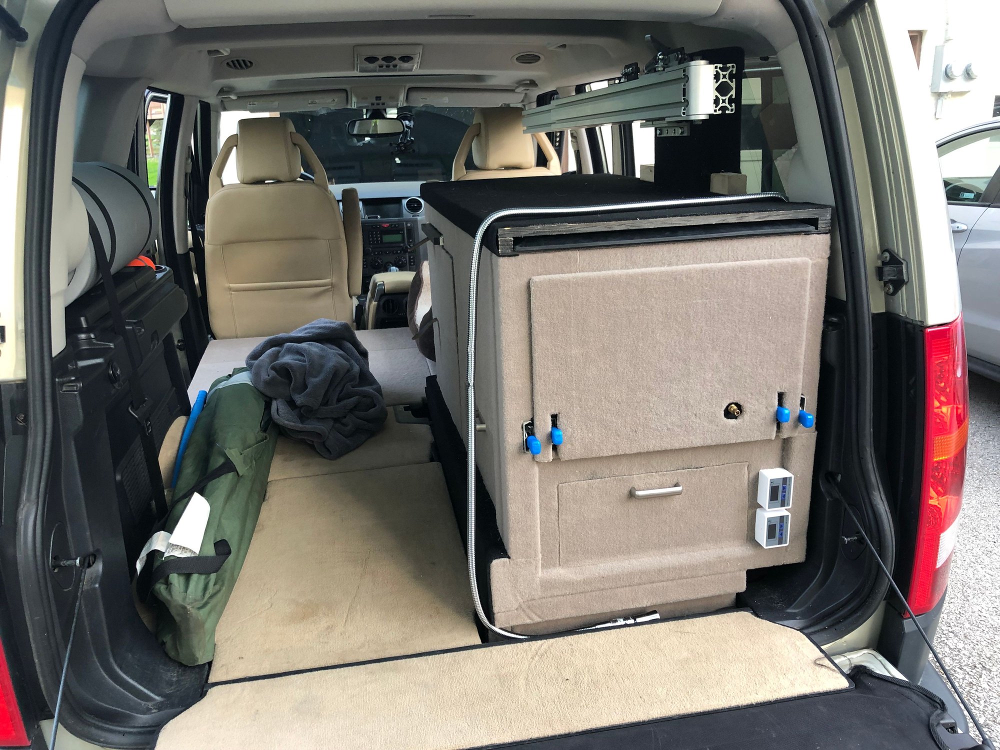

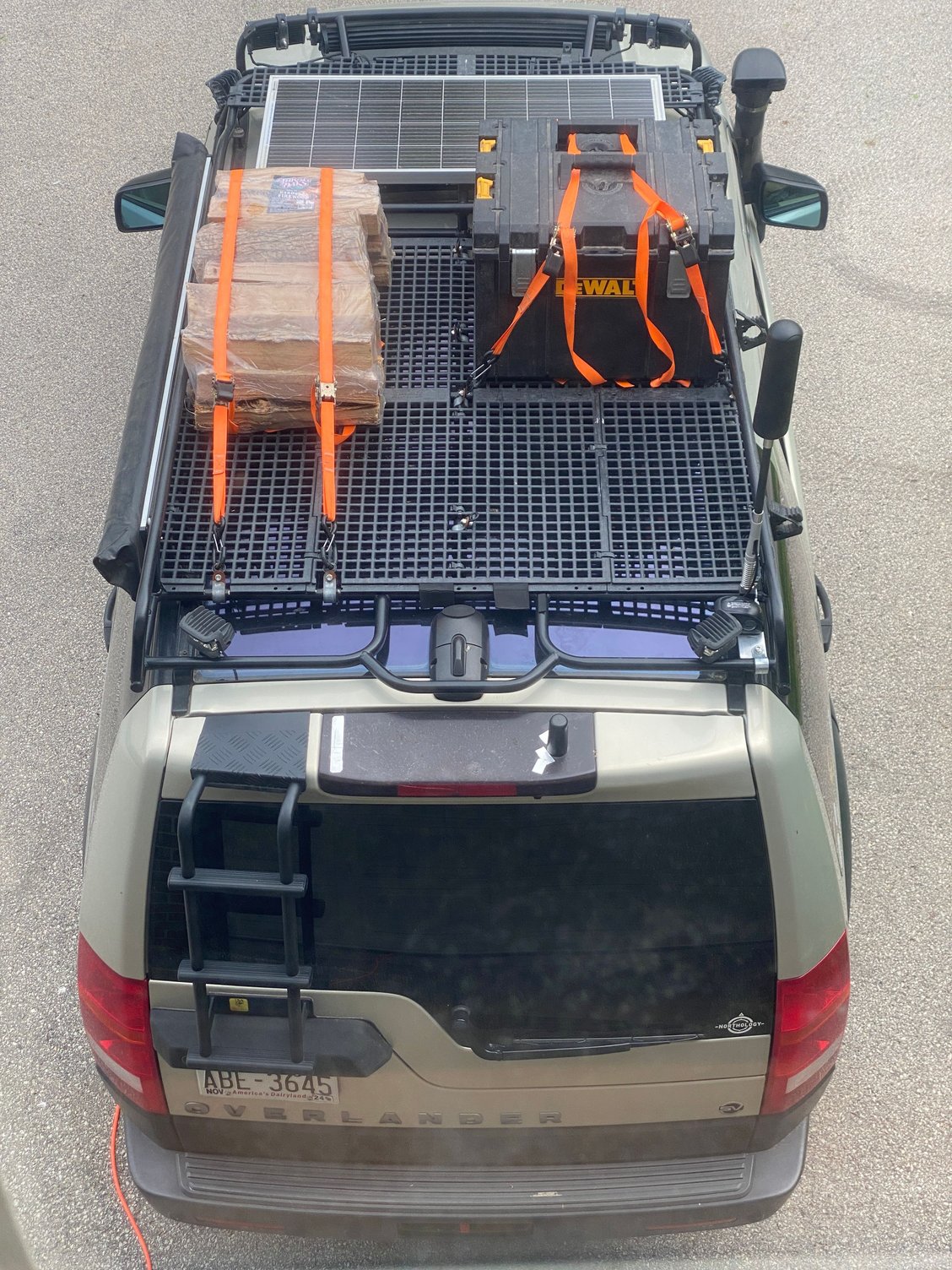

RTT or not, depends on needs. For me, this is not ideal because on long trips there are time when I have to take a nap at a wayside or store parking lot. In those cases I pack in a way that I can sleep inside, stealthily. My roof rack then stores my Dewalt IP68 rated boxes which have food supplies, cooking stuff, etc. I have several and may not use all, depends on the trip. Also on local trips I bring firewood which I would hate to store inside, messy. And yes it has a solar panel mounted which has been a really nice addition. If you get a RTT, you prob still have room for one tho. Inside I keep my sleeping stuff and maybe one case. my tools. But also it is just me and the dog. I sleep with a 2" air mattress with a 1" yoga mat on top that. Makes a great base for sleeping back that packs down easily. I tried memory foam and all sorts of stuff but this combo worked best for me.
Also inside I have a kitchen, fridge and two storage drawers in a module I made (one for common misc stuff like rain poncho, books, lights, tie downs, bug spray, etc. The other drawer for clothes and bathroom supplied. The second row is gone and in place is water tanks for cold and hot water as well as more storage, electors, etc. So you can get pretty crazy with any setup if you put your mind and time to it. But this works for me, may not work for all.
