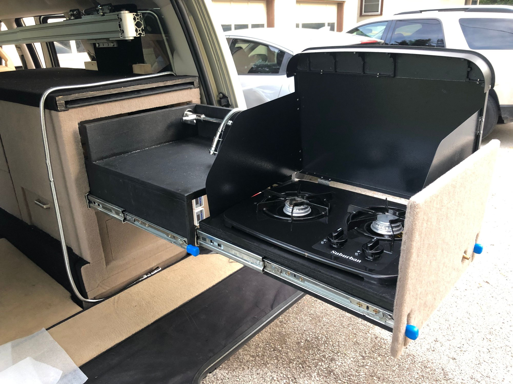

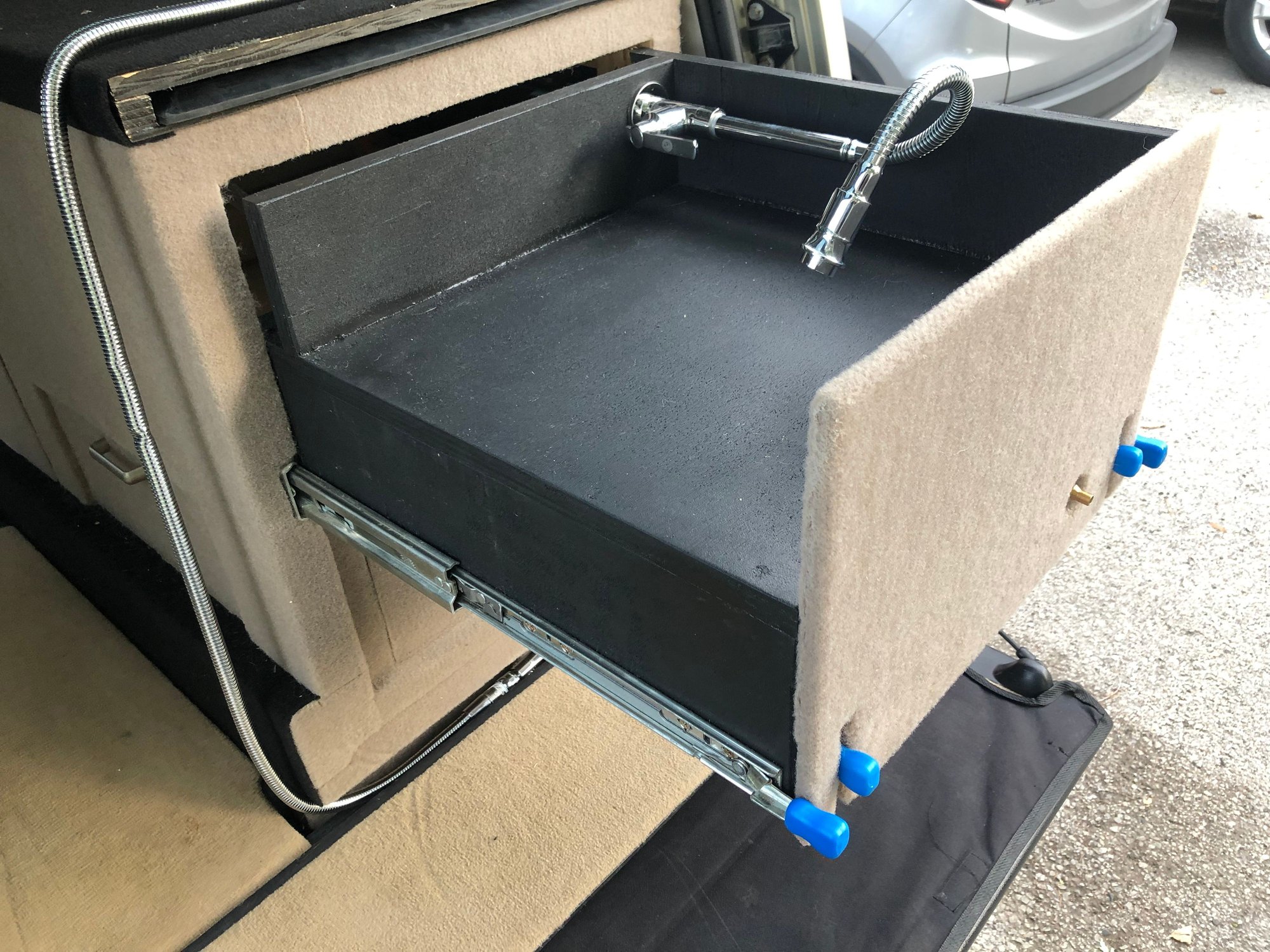

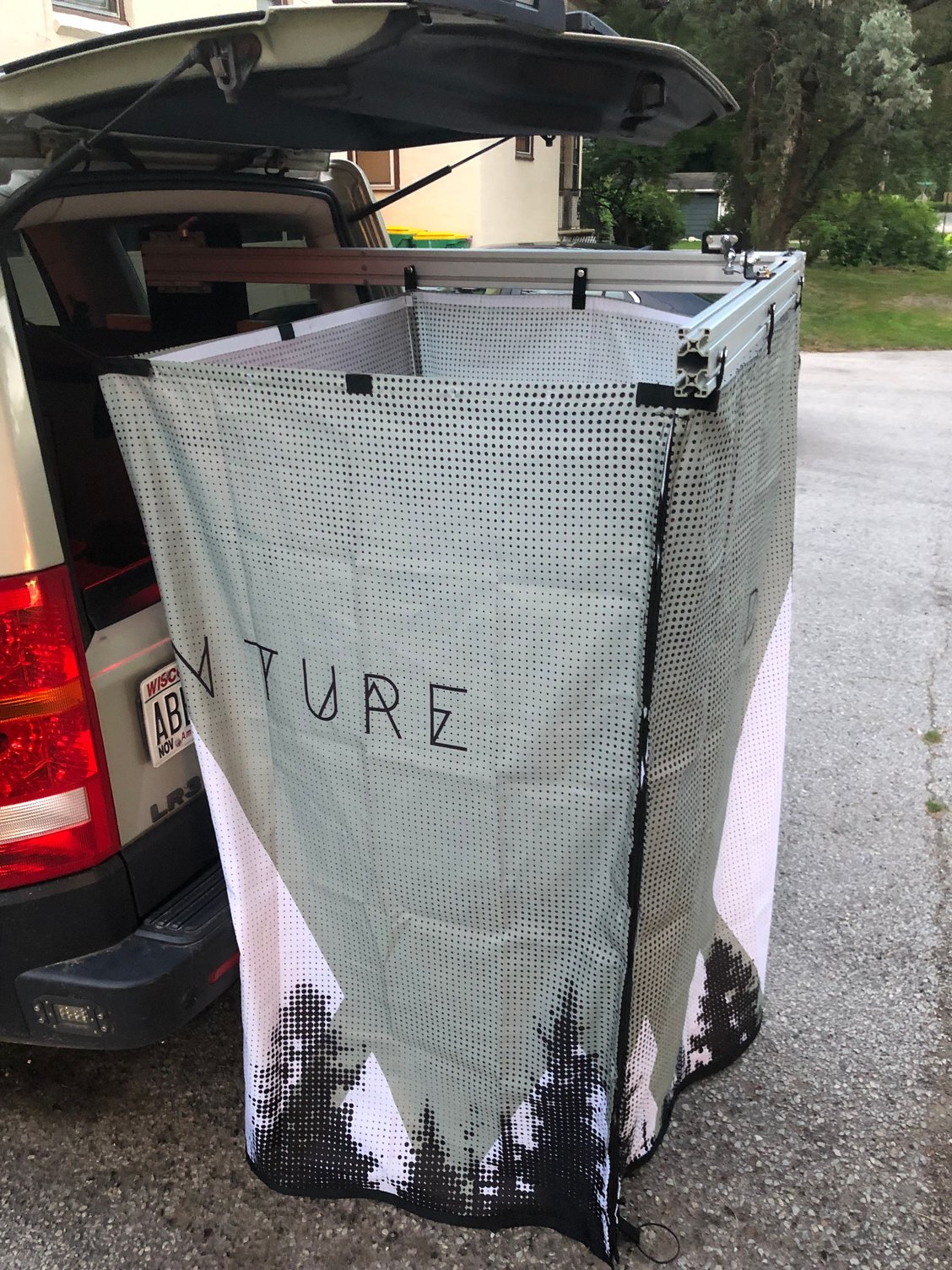

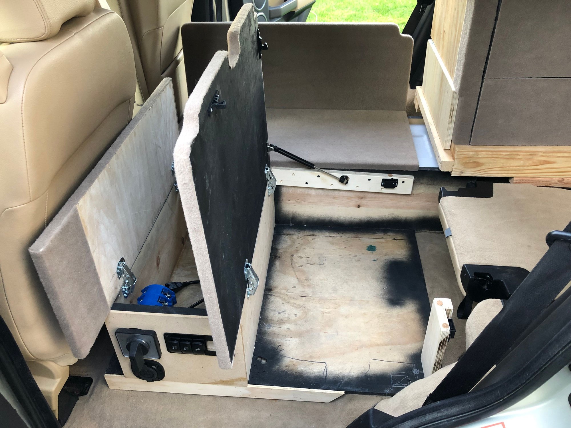

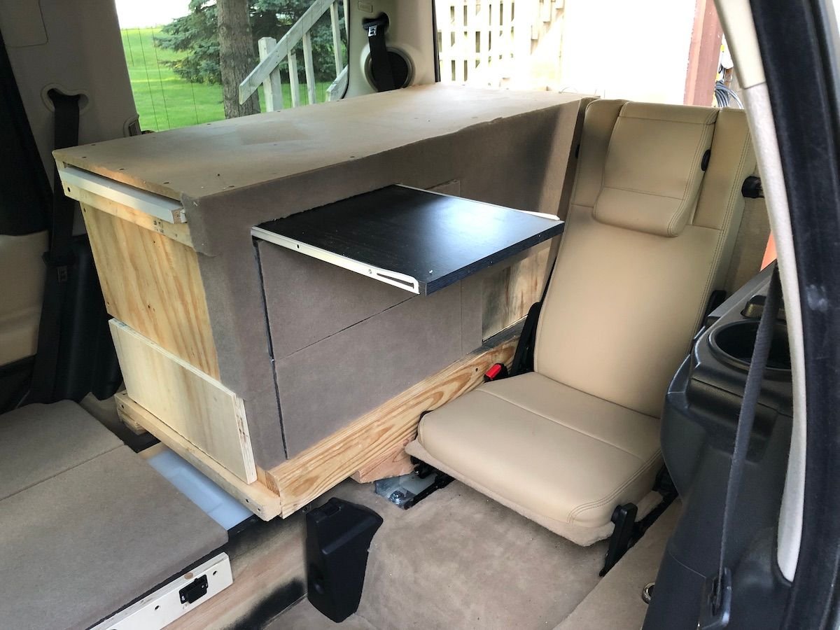

Yeah, second row is gone in place is 15 gal water tank and a smaller water heater tank, pump, storage and electrics. It is only connected via one large power connection via Anderson connector for input and output is one hose for sink/shower and one electrical connector for the kitchen module for fridge, lights. Third row I removed just one seat and built the kitchen drop in module that anchors to the same seat mounts to keep secure. That has more storage, fridge, pull out twin gas cooktop, etc. Mounted to it is 80/20 aluminum slide out curtain that provide shower or restroom privacy. It hook to bumper and has ground anchors for when its windy out. Third seat in back can still pop up and I can hand out back there and stretch out if I want. Solar 150watt panel feeds directly to the aux battery. If I have both batteries connected it will supply both but I dont usually let it sit like that. Pretty much a prototype setup, have plans to make a slightly better design but not a whole lot will change.
Some more random pics, already made some changes and some of these are in progress stages, so it does not look exactly like this now.
