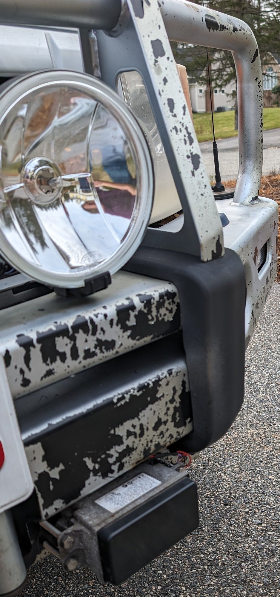

On the Range Rover Sport, the radar sensor mounts behind the bumper off center (on the US driver's side). I have an ARB bumper, and so I drilled and tapped 3 M8 holes for bolts and attached the sensor to the front of the ARB bumper.

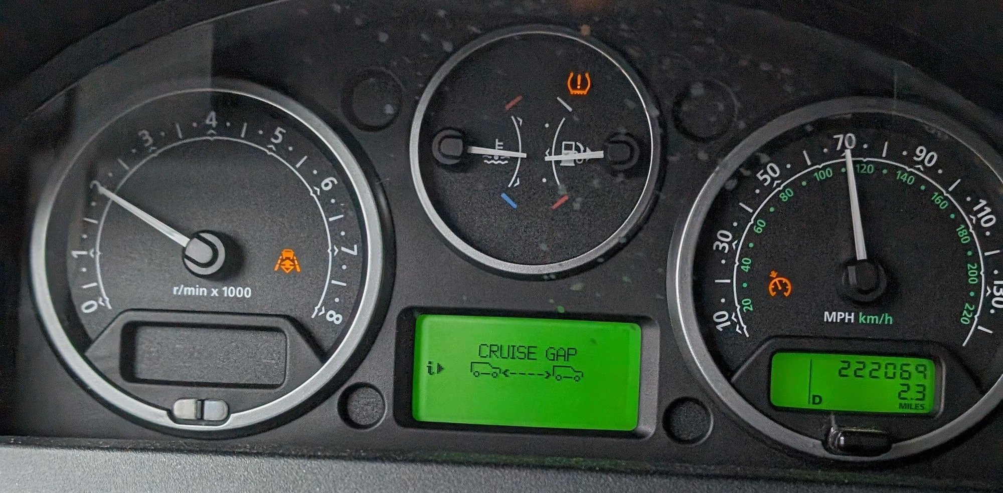

Here's what the instrument cluster looks like when in use on the highway, as well pictures of the module and sensor installed:

I only tested it for short runs getting holiday groceries today, but so far so good. It identifies cars and slows me down as I approach them. In city driving, I drove with the 'forward alert' switch depressed and it did beep at me once and flashed a 'Driver Intervene' message on the instrument cluster when it thought I was closing too fast.

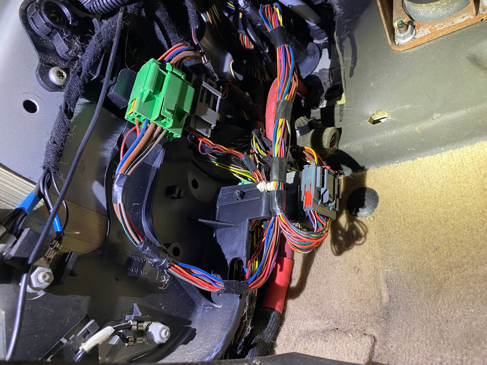

As for the partial engine harness, there's a nearby thread in this section (I posted to it a few days ago) that asks about a mysterious yellow connector in the US driver's side footwell. That yellow connector is the ACC control module connector. Page 16 of that Disco3 thread has excellent wiring diagrams by the way, and I found it easy to assemble my own harness. There are two relevant connectors: 1. the control module connector, and 2. the radar sensor connector. With those, the remaining harnesses can be built relatively quickly.

Being that I have an 06, I was hopeful I had the connector but figured I did not. Sadly I looked and do not believe I have the yellow connector referenced here:
https://landroverforums.com/forum/lr...ng-plug-70066/
