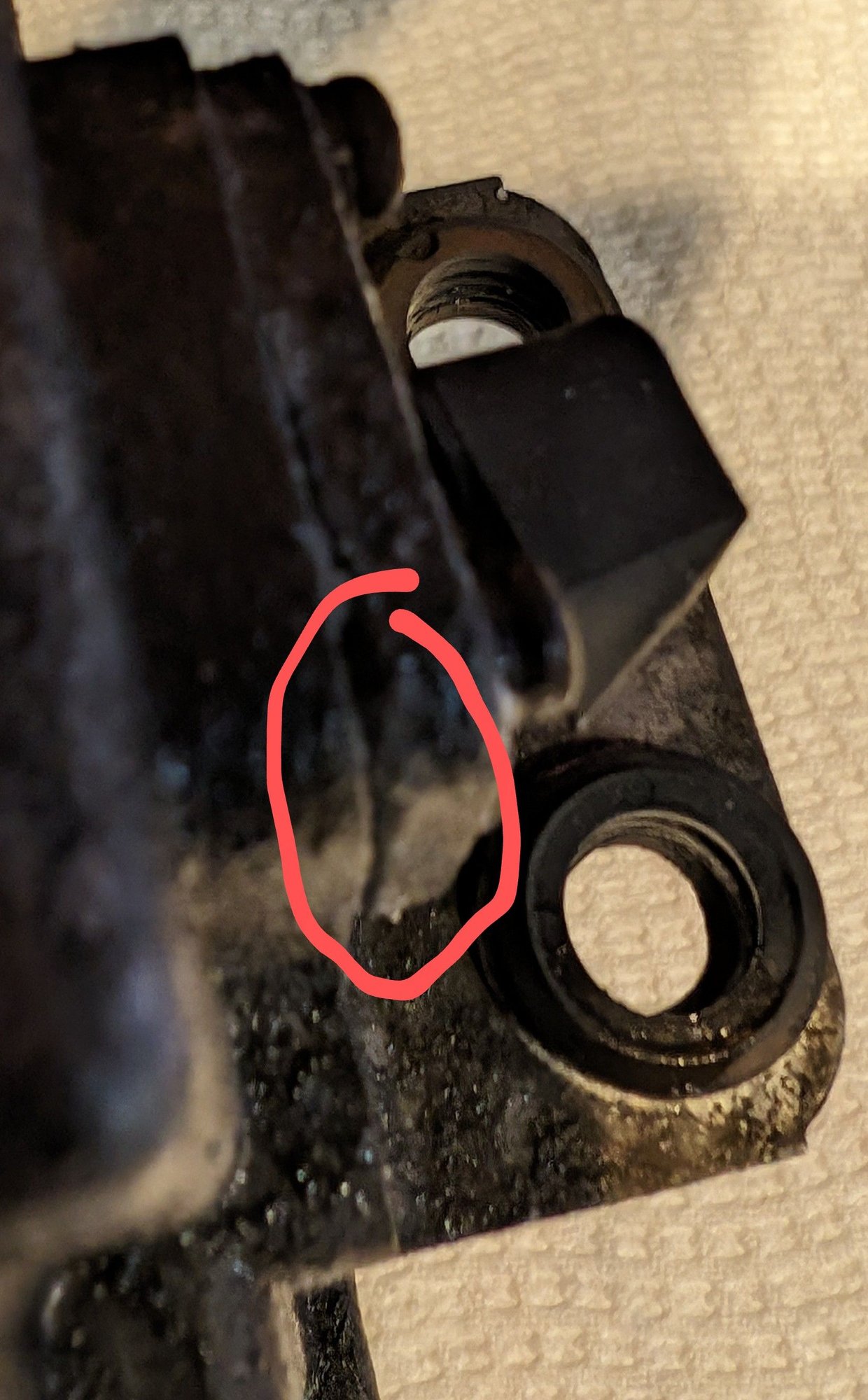

So my radar sensor stopped working a few days ago during heavy rain. I just removed it and found that the adjustment screw plate screws had corroded and corrosion had pushed the plate away from the housing and removing the plate (the 4 screws were pretty much toast, I needed vice grips and 2 broke in half on removal) revealed significant corrosion. The faceplate looked ok and the plug connector housing as well, so for now I'm drying it out and will see if that brings things back to life but I've got a replacement on order.
I suspect that the gap allowing for water ingress was present when I installed it, and so I would recommend going over all the seams of a radar unit and perhaps putting a preventative layer of silicone. I have the adjustment housing cover removed and if drying out the unit fixes it, my plan is to leave the cover off and just seal the entire area (it's like 1 square inch) with silicone.

Bummer!! I have read in a few places that the radar modules are prone to failure from water ingress. Which is why I wont order one until I have all my other parts installed. Because *most* sellers have some sorta warranty or policy against DOA. So if I order one now, it could be on the shelf a while and exceed that time window. At least new ones can be found for less than $100.
Question, which version of that module do you have? I ask because the -BC variants seem much more common than the -AA. I am wondering if the -BC modules will work with the -AA ECU properly. Also being a -BC, I wonder if they improved the water tightness.

New radar module arrived and system immediately started working again upon the swap; water must have killed the first module. This replacement looks to be in better external condition but I may 3d print a cover to protect against weather.
