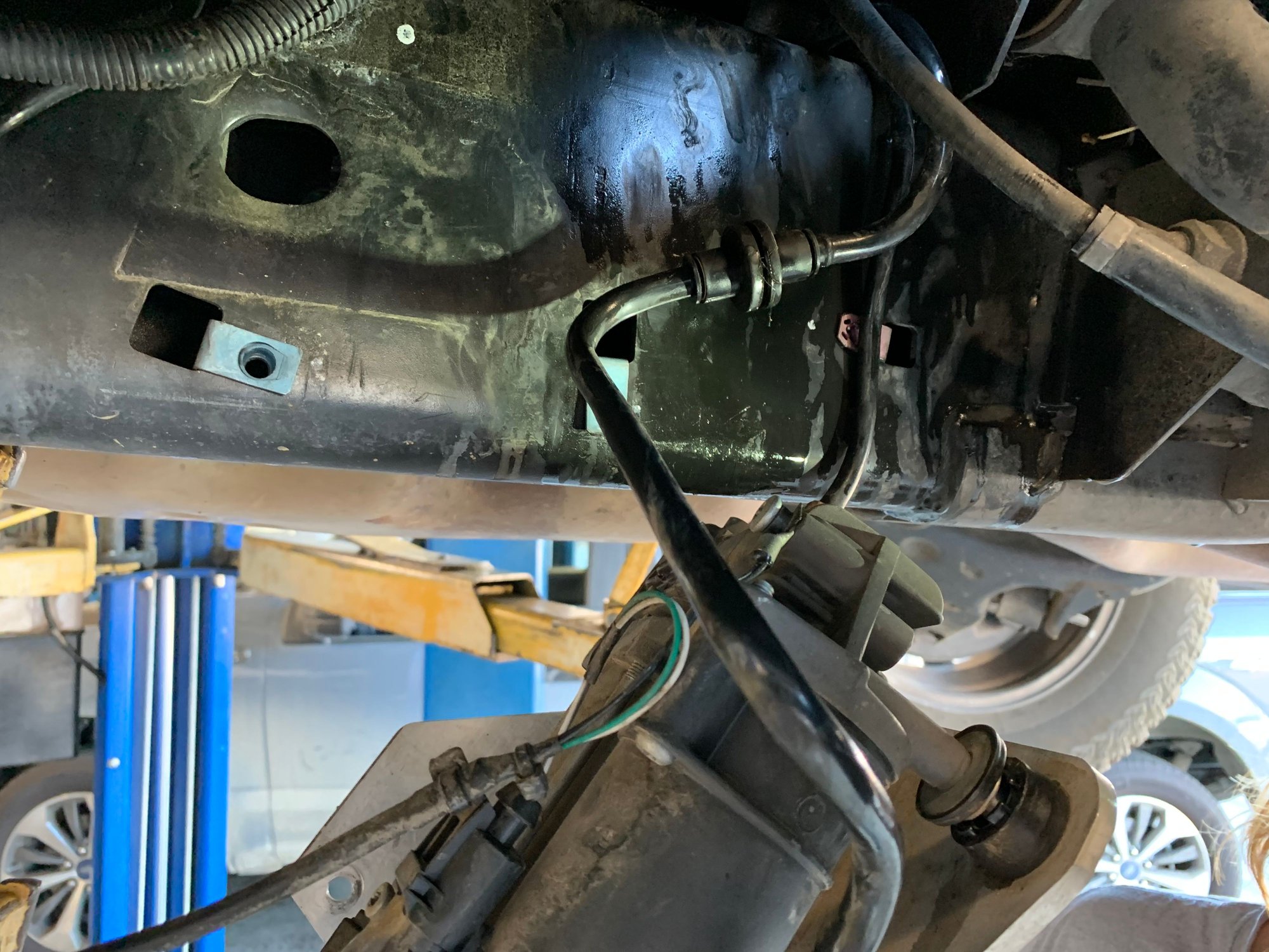

I think we found the leak. If the LR3 sits for even an hour when you restart the truck the air compressor comes on. I found this fitting that leaks when the compressor is on. I think it is causing the air tank to empty. What is this part? It leaking right at the center of the coupler.

That looks like the exhaust pipe for the compressor. I dont see how it could leak in a way that would affect the suspension. I have run compressor without the intake or exhaust even hooked up.

That's good to know. I think you're correct with exhaust rather than my post of intake. I didn't know the system would operate without intake or exhaust attached.

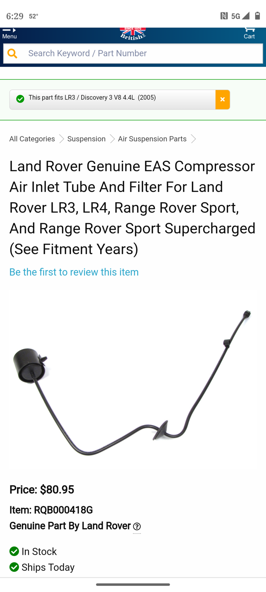

I agree with you on that it shouldn’t affect the suspension. I spoke with Nathan from Atlantic British and he suggested we start with this $40 pipe kit. Just haven’t put it on yet.
