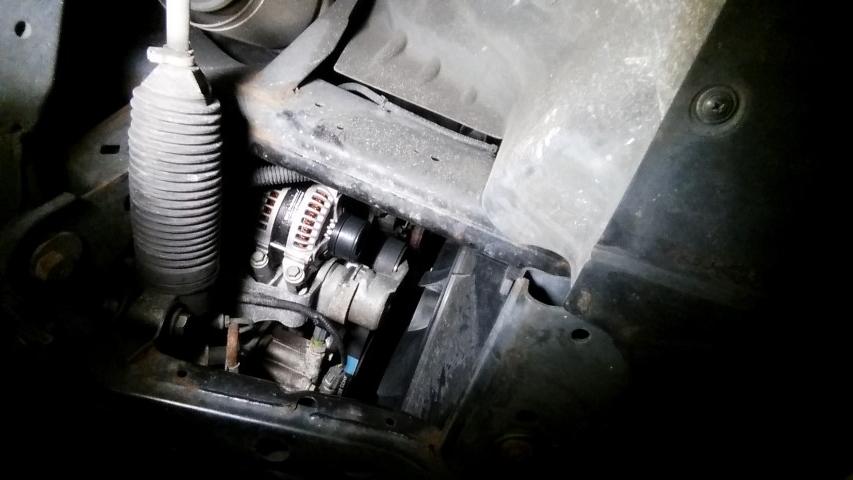

I was under my rig the other day and noticed how exposed the alternator was.

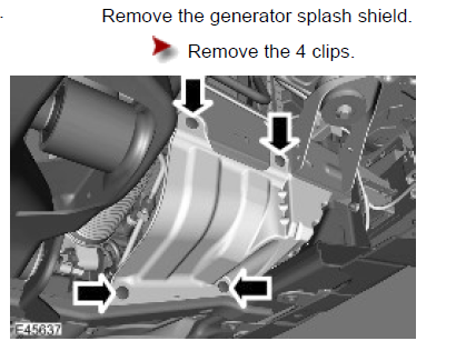

I also noticed there were several holes in the frame rail that looked like they would facilitate a cover of sorts. I was looking through the workshop manual and found this:
Was this an option, or am I supposed to have this? Does anyone know a part number? The PO replaced the alternator shortly before I purchased, I would like to make sure it lasts!

Definitely not an option. You should have that. I don't have a part number but I bet someone will on this forum.

seconded. you should definitely have a cover there. Sorry I do not have a part number.

Just as a follow up for anyone else that comes across this thread, I finally got my Microcat installation working and found the parts - KRN500042 for the right shield and KRN500052 for the left shield. (They are referred to as "Generator Splash Shield" or "Side Shield") The clips that hold them in place are ANR2224. I ordered everything I needed from Land Rover Virginia Beach for ~$69 (includes shipping).
