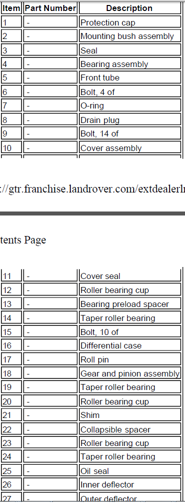

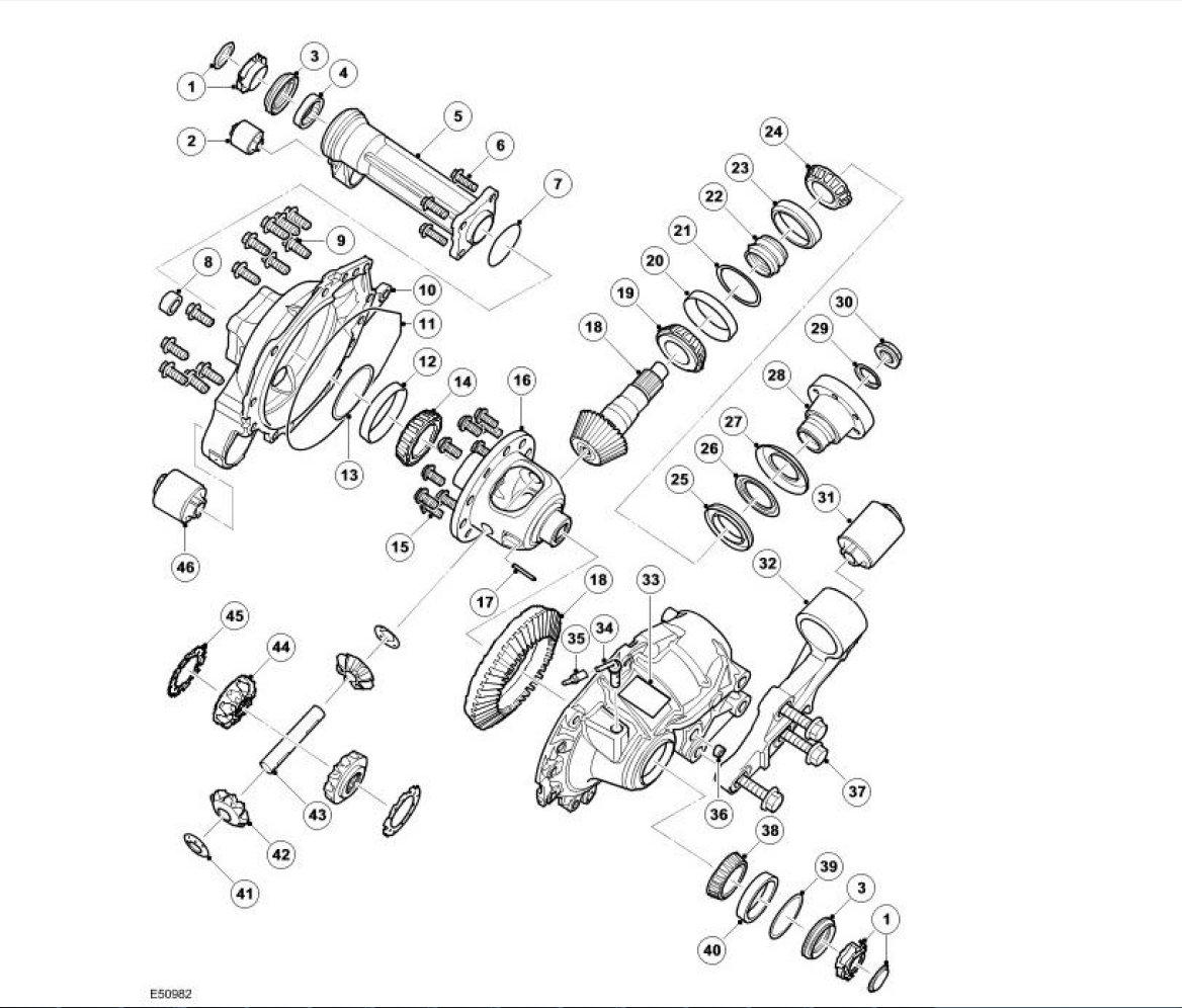

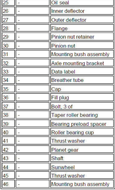

Thanks for the info. From the picture of the ARB locker and bearings you posted it looks like it came with seals (parts #3 axle seal and #25 pinion seal) is that correct? Did it come with a new crush sleeve? That's the part that used to set the pinion depth/preload. It's #22 (collapsible spacer) in the diagram below. If not did the tech reuse the old one? Install a new one? If so any idea what the part number is? Thanks again!
Attached Thumbnails Anyone Installed an ARB Rear Locker on LR3-lr3-frontdiff1.png   Anyone Installed an ARB Rear Locker on LR3-lr3-frontdiff2.png   Anyone Installed an ARB Rear Locker on LR3-lr3-frontdiff3.png
Old Apr 13, 2015 | 07:54 AM
  #40
morrisdl's Avatar
Joined: Apr 2009
Posts: 219
Likes: 36
From: Smith Mt Lake, VA
Neither - not sure there is a part number for that. ARB Kit did not come with a pinion depth/preload crush sleeve. The LR tech had a new one left over from a previous diff rebuild that he didnt use.
