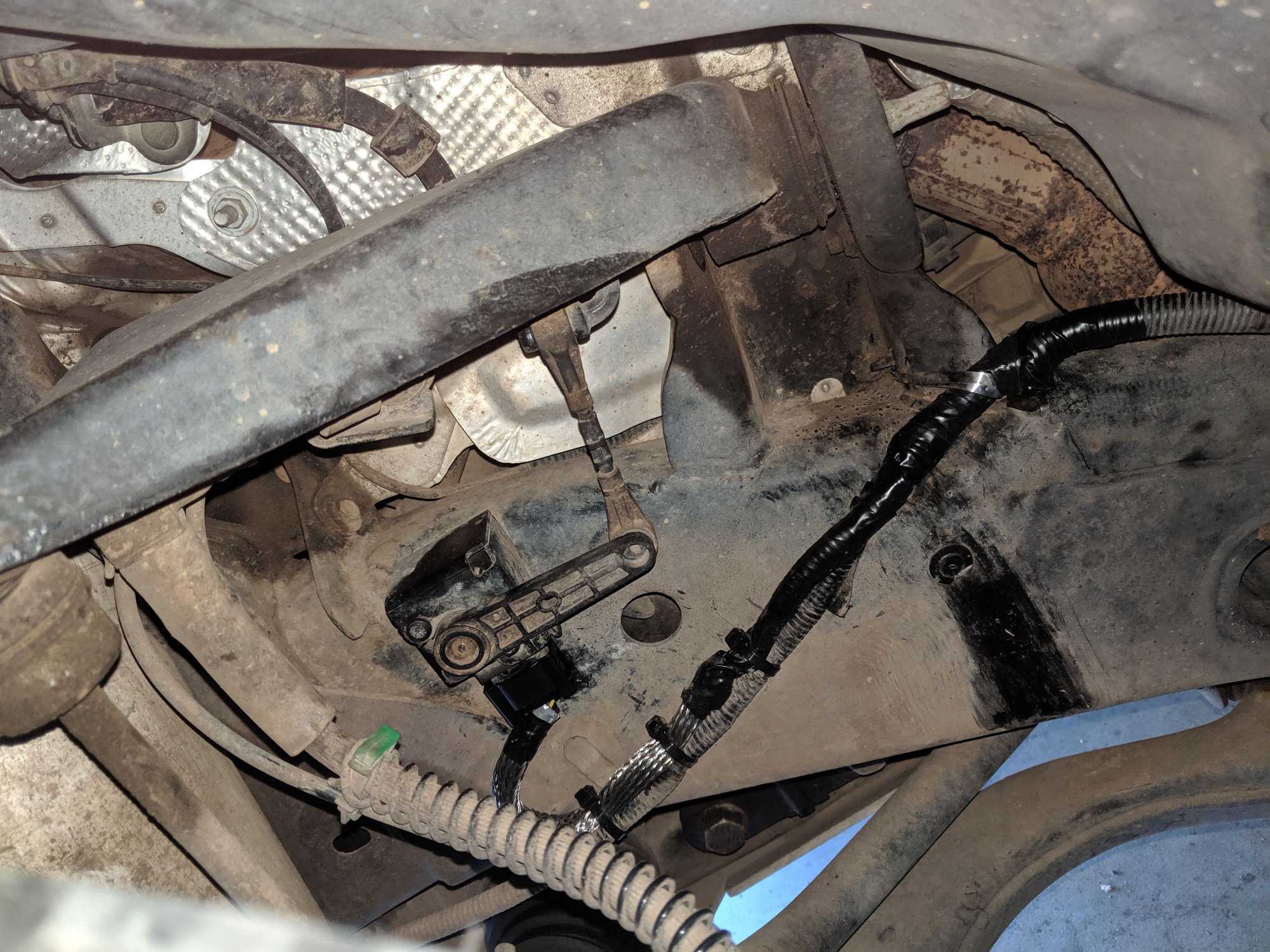

@DakotaTravler I run the same size tire...Coopers, which are a little larger than other brands, but I don't see how you can have "no rubbing" unless you mean just driving around on the streets.... but even then in Access Height there is gonna be some. No way anyone is backing into an inclined driveway at full lock in Access Height and not rubbing 275/65R18s. Not stock, anyway.
The wiring harness.... definitely needs to be relocated if you wheel your LR3...even then I ripped mine down a few years ago and re-secured it with stainless steel mesh and zip-ties.

Old Jan 29, 2023 | 01:27 AM
houm_wa's Avatar
Joined: Apr 2009
Posts: 4,245
Likes: 482
From: North of Seattle
This is the after shot. The stainless steel mesh is throughout but covered by plastic conduit and tape
Not the same area i had to mod, no rubbing there for me.

Originally Posted by houm_wa
What's the point of the liner heat-gun mod? Once you flatten the metal behind that plastic bulge, who cares if a tire rubs there?
Which wiring harness are you referring to houm_wa?
Old Jan 29, 2023 | 12:59 PM
houm_wa's Avatar
Joined: Apr 2009
Posts: 4,245
Likes: 482
That's the wiring harness from the driver's side front height sensor that is mounted to the frame rail and goes to the compressor.
@loanrangie Yes different area. That's a pic of how I re-routed the height sensor wiring. As for the bulge in the rear wheel well, after I removed the lining and pounded the chassis join flange flat with a Blacksmith Hammer (and hit it with primer just to be safe) there is nothing behind the plastic bulge to rub on anymore.
