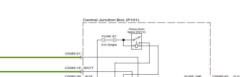

Do you have a relay in the spot for the autolights?

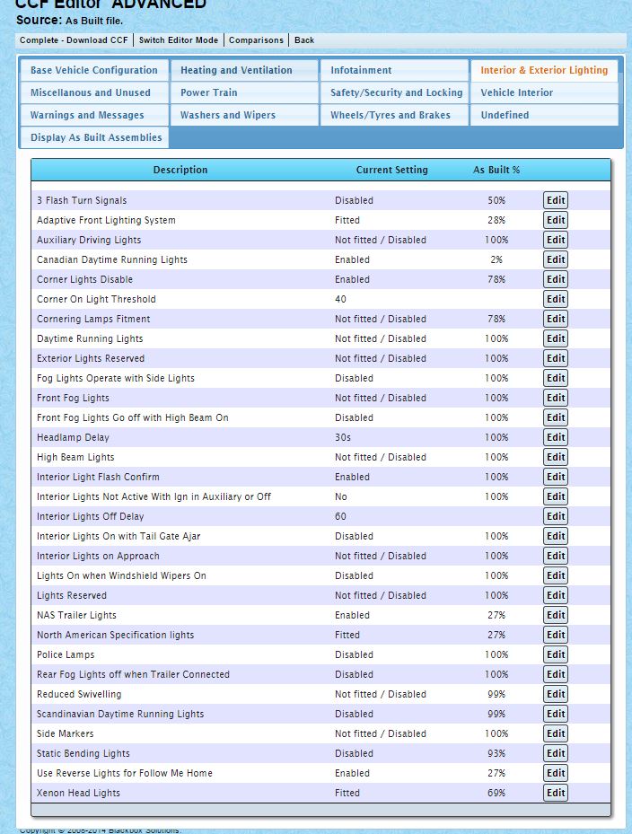

I don't see anything, but I've overlooked stuff before. This is what is in the lighting options (some may not apply, because the CCF is for a lot of other vehicles too, Ford, Volvo, etc)

ok that fuse is located behind the glove box, where is the relay located?

It shows it as being in the "Central Junction Box", which I can only assume is the fuse box behind the glove box. I believe the one under the hood is the "Battery Junction Box".
