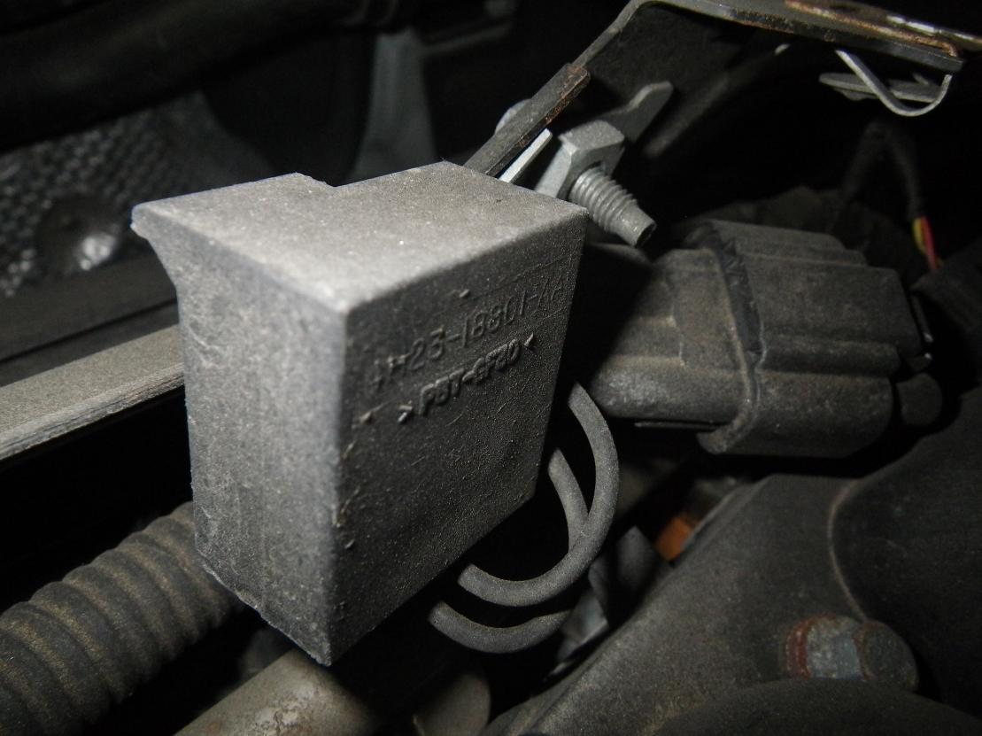

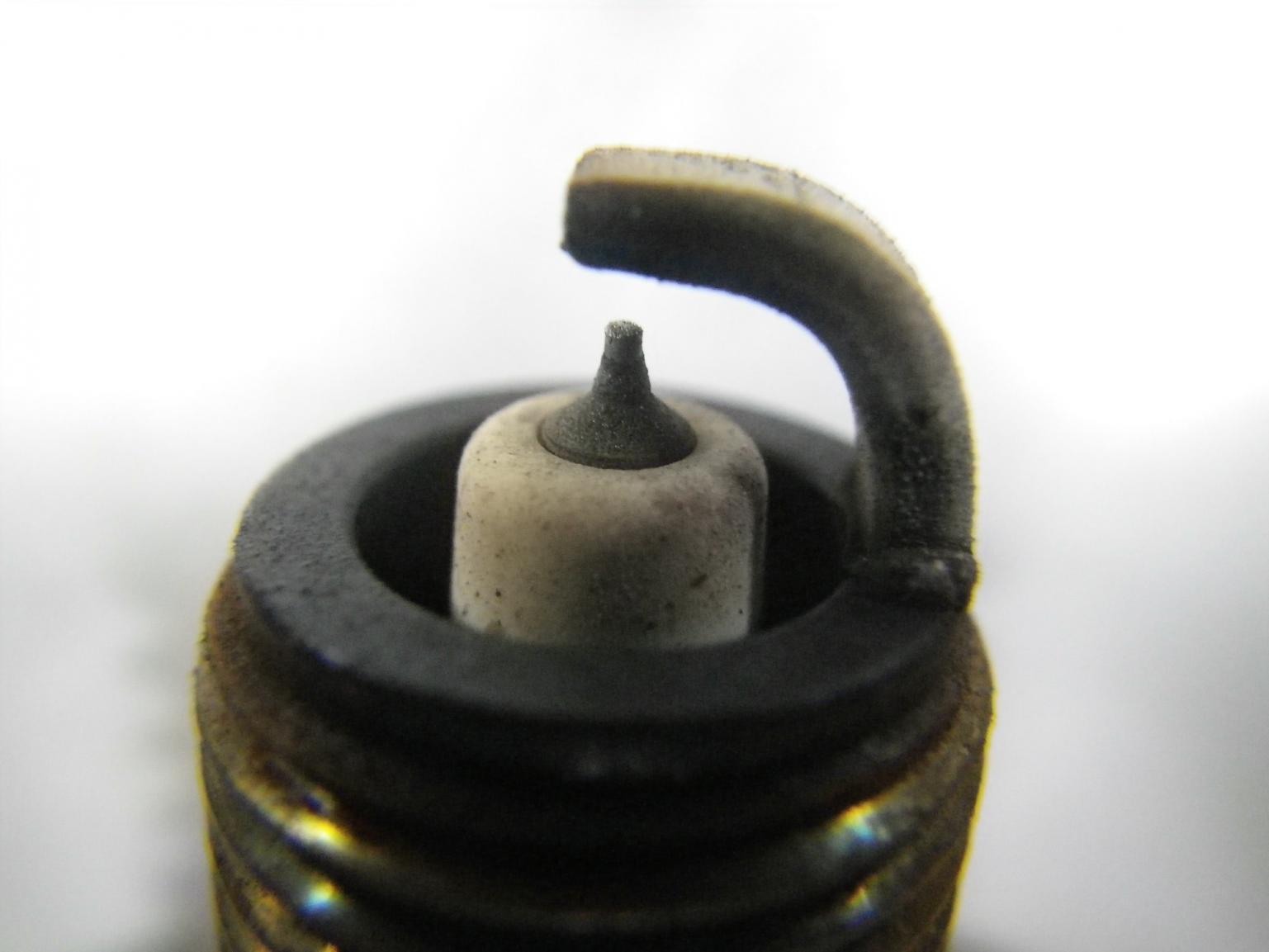

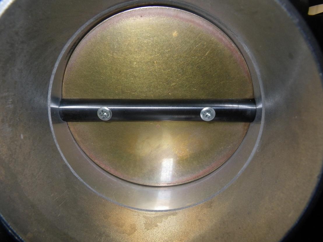

Here are a few pictures from a vehicle I just serviced. Preformed a air induction, and fuel injection service, along with a major tune up.
This vehicle was not bad, and the service was preformed as maintenance due to mileage, as opposed to for an issue, but from test drives before and after, there is still a noticeable difference in both performance, and overall drivability.
Before and after shots of MAFS, Throttle Body and Intake, Spark Plugs(new ones installed, picture shows before and after injection service) new vs old capacitor, and new PCV valve installed.
Attached Thumbnails BG fuel injection/induction service-imgp0053.jpg   BG fuel injection/induction service-imgp0061.jpg   BG fuel injection/induction service-imgp0066.jpg   BG fuel injection/induction service-imgp00671.jpg   BG fuel injection/induction service-imgp00701.jpg

Sorry for the newb question, but are the first two the ignition capacitor? If not, which one is?
Old Jun 24, 2013 | 07:12 PM
thorgal's Avatar
Joined: Aug 2008
Posts: 343
Likes: 34
On First two ,dirty MAF sensor is shown,whereas ignition capacitor is shown in the last one of the first batch of pictures, the old part ,that is.New I .capacitor is pictured on the third ,one row below.
