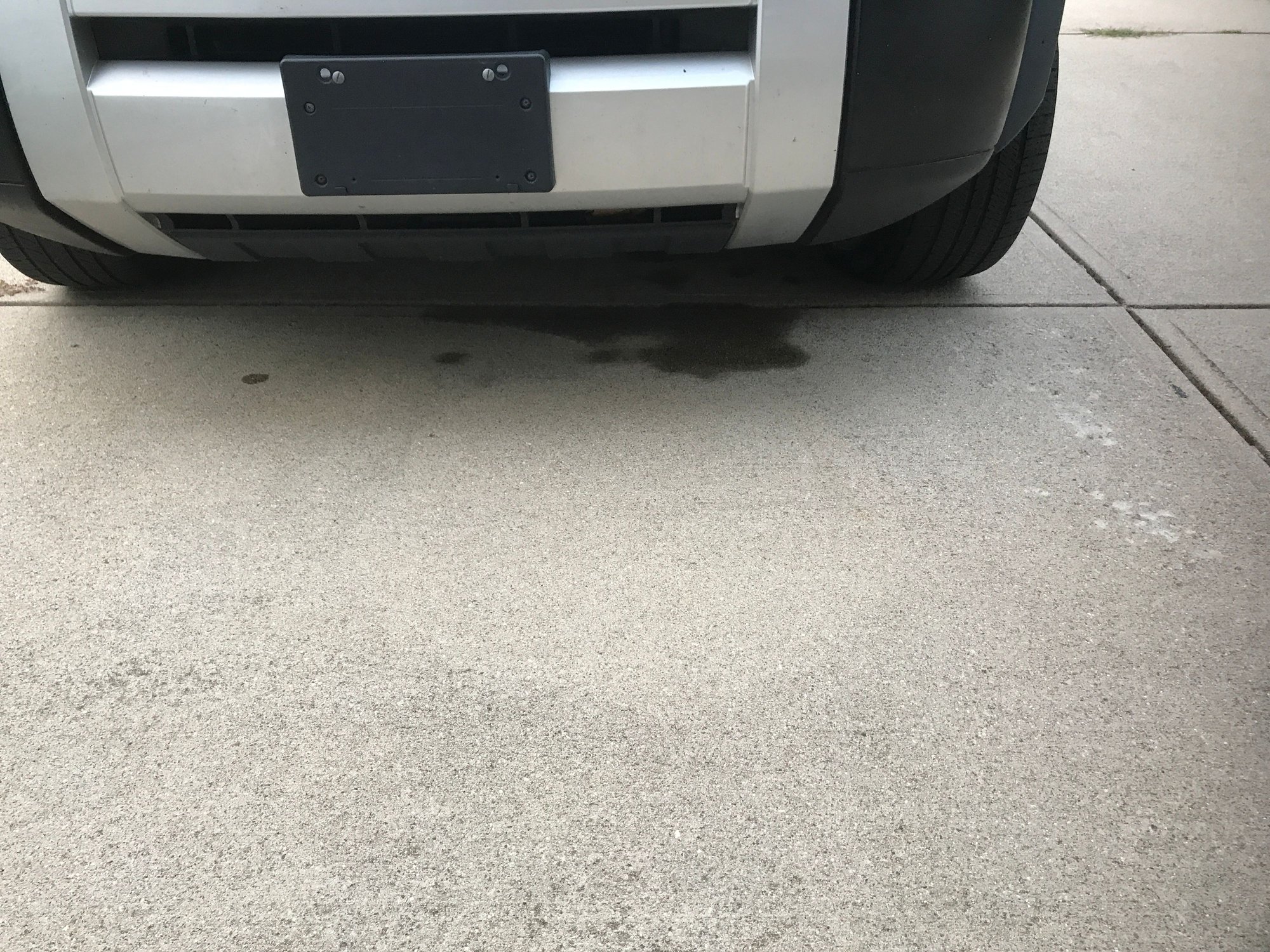

I have an lr3 2006 replaced thermostat cover and water pump now Runs hot and leaks from the bottom... Did I blow a gasket too, could it be something else

Did you hook the electrics back up on the fan?

I will ask my mechanic about the electronics on the fan... It leaks now from underneath the front on the drivers side. It was not doing this until I changed the water pump.
