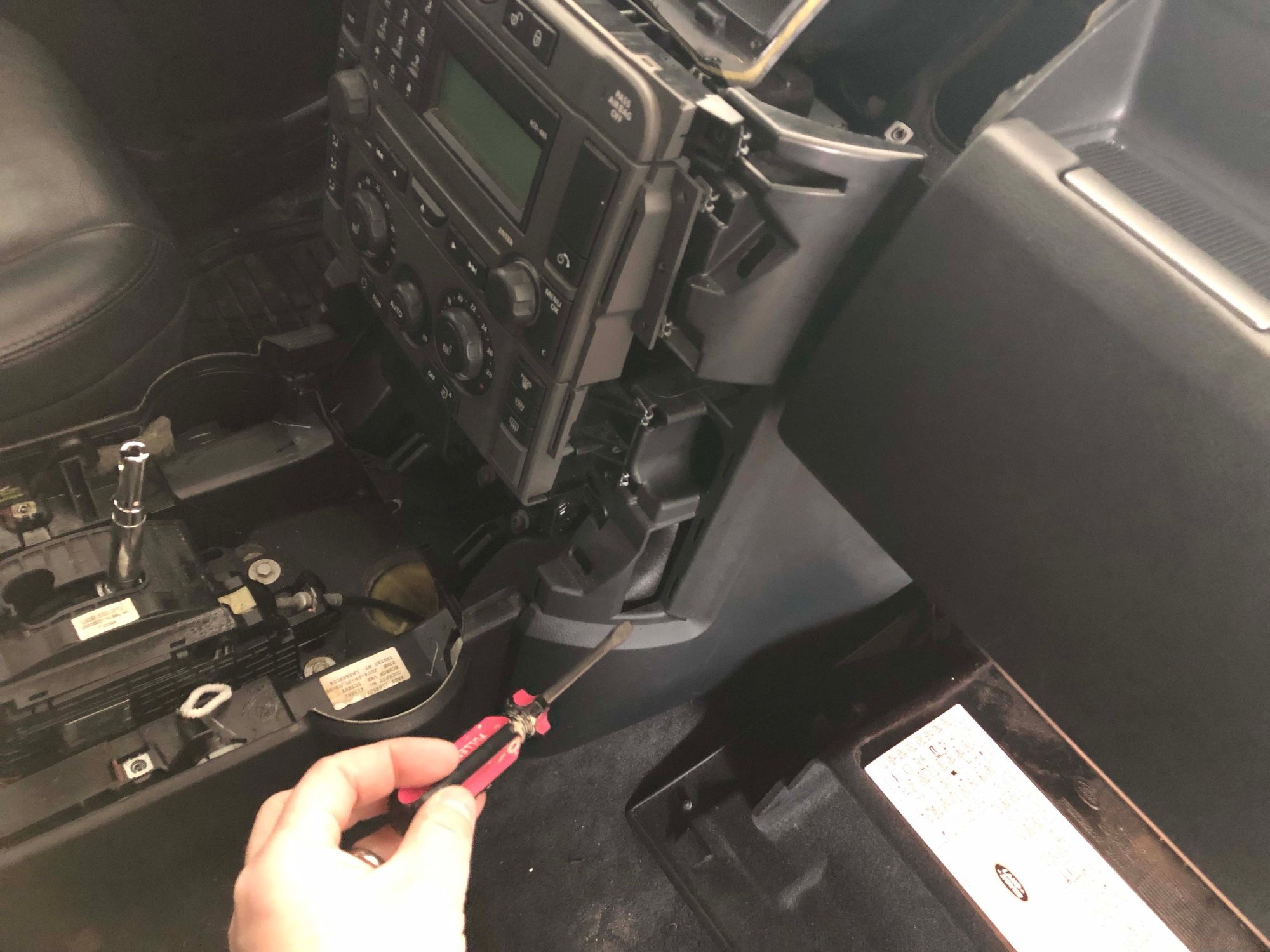

I really want to remove the carpet and let the whole thing dry out. At the same time, I want to remove the passenger side dash because then I can replace the sunroof tube which I sure is the issue.
But I am stuck - How can I take the rest of the side out adjacent to the glove box (with the glove box at the same time...?)
This way I can really get to the carpet, get to the rain tube and possibly look at the heater core.
How much of the centre dash to I need to remove to be able to get the whole passenger side out? (am pointing to it with the screw driver)

The carpet is one giant piece from the firewall to the 2nd row seats. You'd need to remove the center console, seats and amp under the passenger seat (i'd get the amp out asap and try to dry it out before corrosion sets in unless you have a base model which has no amp).
Maybe try youtube to see if someone has a video on a heater core replacement. I haven't removed that section you're pointing to, and I wouldn't want to honestly.

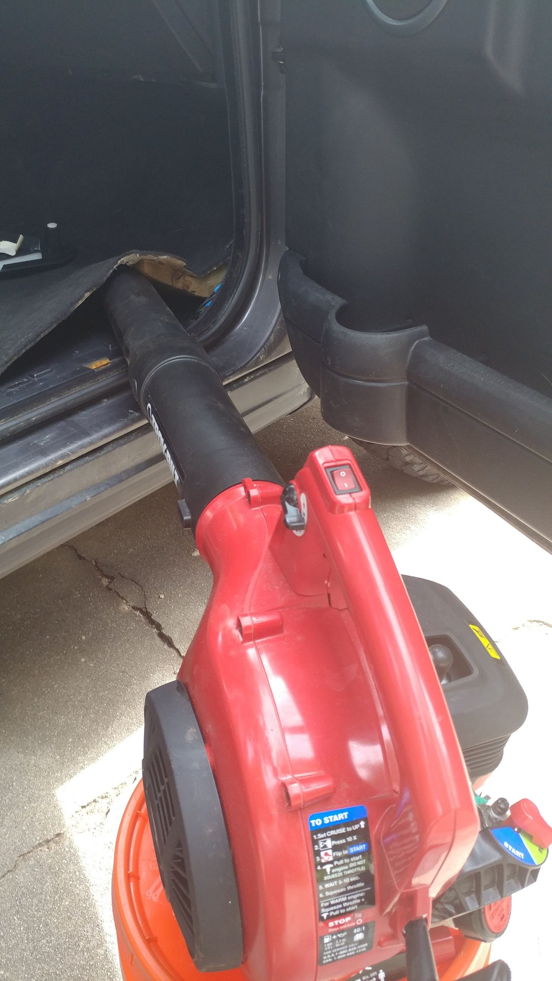

Old Feb 20, 2019 | 09:08 AM
I used my leaf blower to dry mine out lol
Old Feb 20, 2019 | 11:04 AM
Blackngold77's Avatar
Joined: Jul 2018
Posts: 395
Likes: 80
From: Las Vegas
hahaha.
I stuck a big maglite under the carpet to hold it up and set up a heat gun at the opening (~1 ft away). just checked it every 30min or so to be sure i didnt burn the truck down.

Just removed this dash section on mine... its not too bad; as indicated above seats, amp, and media module (drivers side) need to come out... then center console (check you tube for a quick tip on shifter removal - its easy - but not what you might think) 2 torx in front, 2 small ones behind the 'vent panels in back to get the while console out ... then radio, heater controls, ash tray, nav, and hazard/lock module need to be removed... and then you're ready to remove the center dash -> 6 or 8 torx bolts hold it in... there is another metal piece that connects the center dash to floor that needs to be removed if you want to pull the carpet out. lastly the antenna cable has an annoying connector that i broke trying to remove as it goes through the carpet (argh) ... all that said -> i would try the blower or heat gun approach before tearing everything apart ... it is straightforward but time consuming.
