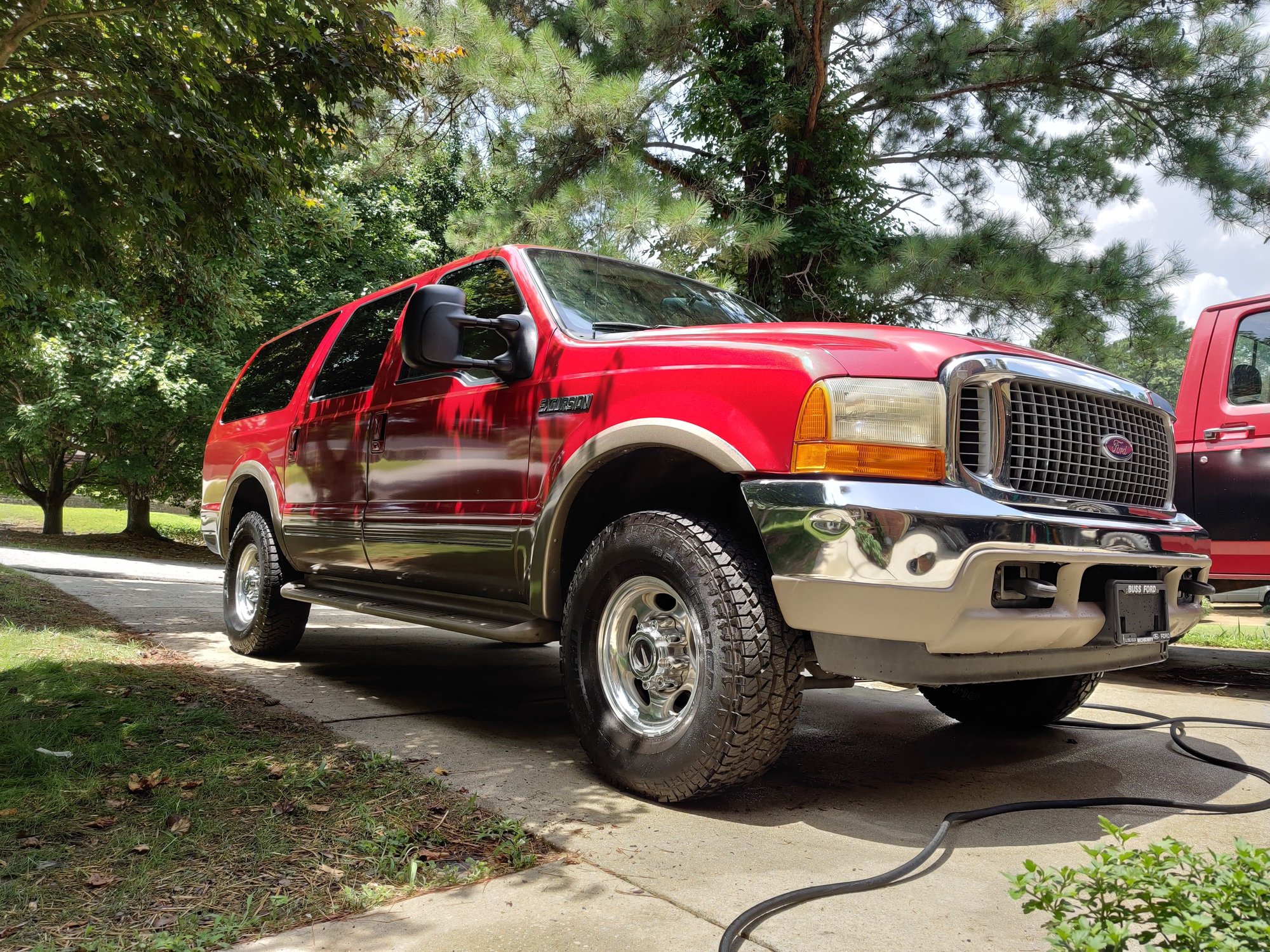

Nice Excursion in the background, I miss mine.
Old Jul 9, 2019 | 06:47 AM
I dig it to. Only downside is it has a serious drinking problem. The 4x4 V10 makes Rovers look efficient lol
I had the 7.3L TD, much better mileage.
