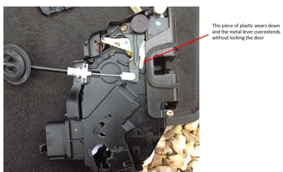

The issue... Passenger front and rear doors won't lock with the Key FOB. If you used the FOB to lock doors... you could open the Passenger doors and the alarm would go off. I heard this is a common
issue with LR3 and LR4 door actuators. There is a little white piece of plastic lever arm that wears down and the metal arm isn't able to activate the lock. Here is a picture of the piece that wears down.
Another crap design from our LR factory friends. The correct fix is to replace the entire actuator. LR dealers wants $850 per door. Chinese Actuators are $100.

But there is also a hack that seems to work. I'm sure I am just buying time till the actuator actually fails... but I heard from someone that used this hack and it has worked for 2 hears of daily use.
The key is in the little metal level on top.

Now we have full access to the mechanism. From here simply take a good pair if needle Nose Pliers and insert on top and bottom
of the metal tab... then grip and bend about 20 degrees to counterclockwise. Here is what the bent tab looks like. Notice the difference in the bent picture
and the 1st picture I posted. You can see the piece of Flat metal is now bent downwards and has a but of a hook on it.

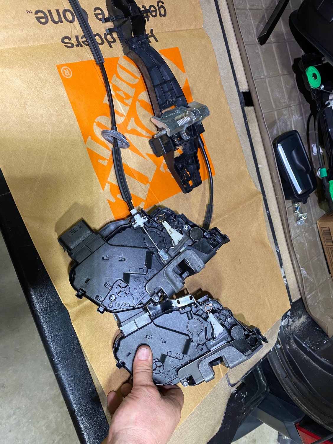

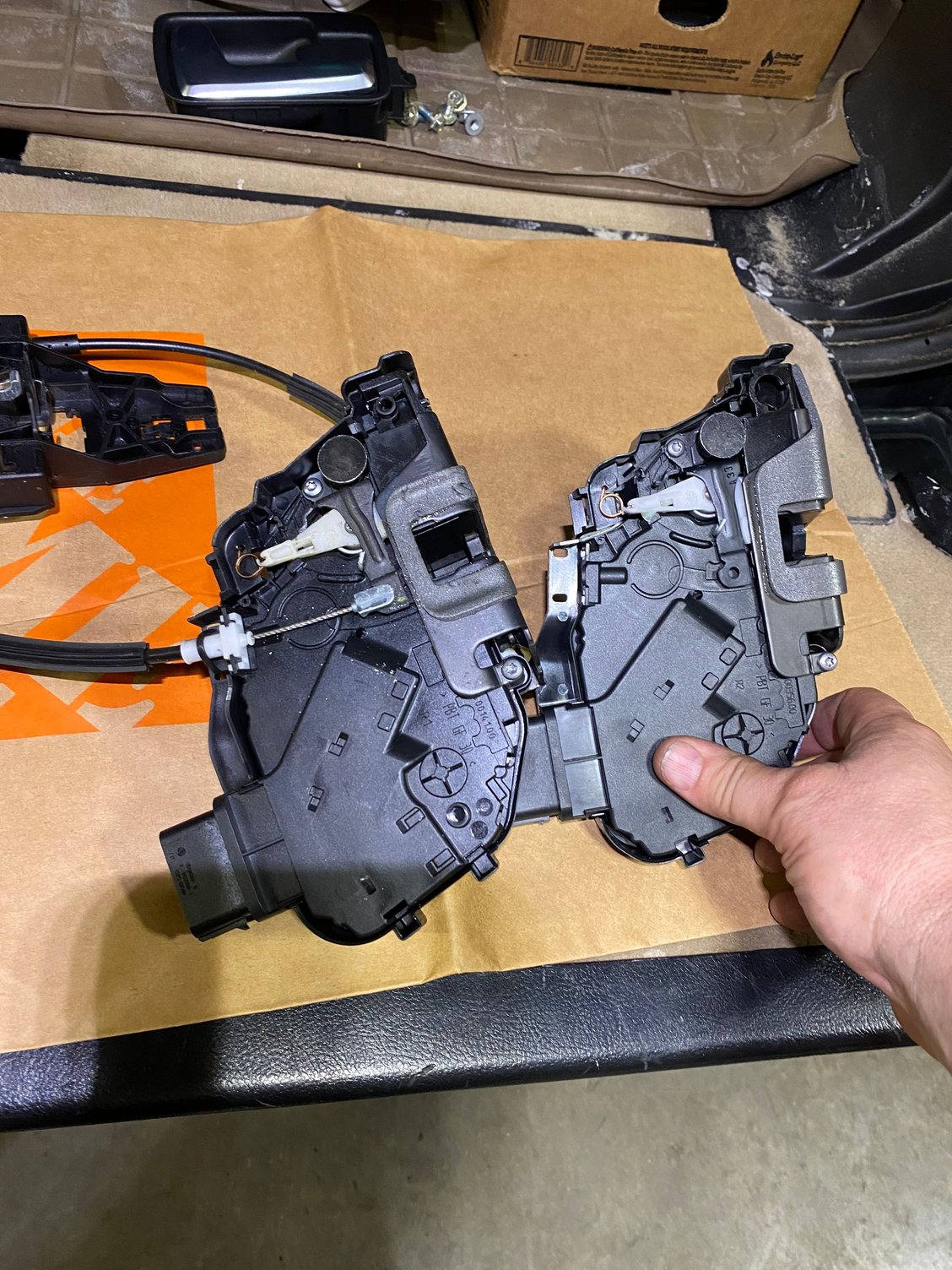

I ended up buying a new actuator.
The actual failure is where the white plastic piece breaks. You can bend the metal tab to compensate where the electric solenoid will actuate the lock, but manually operating the lock doesn’t work well.
After bending back forth many times, I bit the bullet. The new OEM actuator works great, manually or electronically. Here is a side-by-side. If you zoom in, you can see the white plastic tab.
