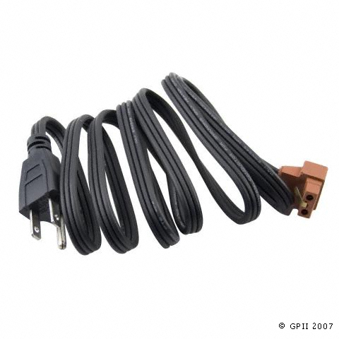

Straight plug variants of the cord have the base Temro number of 3600003
KATs cord 28451 (shorty 1') $18 NAPA, not in stock locally
ZeroStat 3600003 (5' I think) $17 O'Reilly & NAPA Autoparts, online only
90 degree variants of the cord have the base Temro number of 3600001
CQ heater parts 78060 (5' I think) $17 CarQuest, not in stock locally
O'Reilly & NAPA carry it online, interestingly it's slightly cheaper around $13
The only one I nailed down was an auto supply company selling through ebay, they have both 3600001 and 3600003 in stock around $17 and would ship same day out of Iowa. HERE
Of course if it isn't actually installed on my LR3 this is all pointless since it's almost March and I'm not dumping my coolant for a block heater now.
