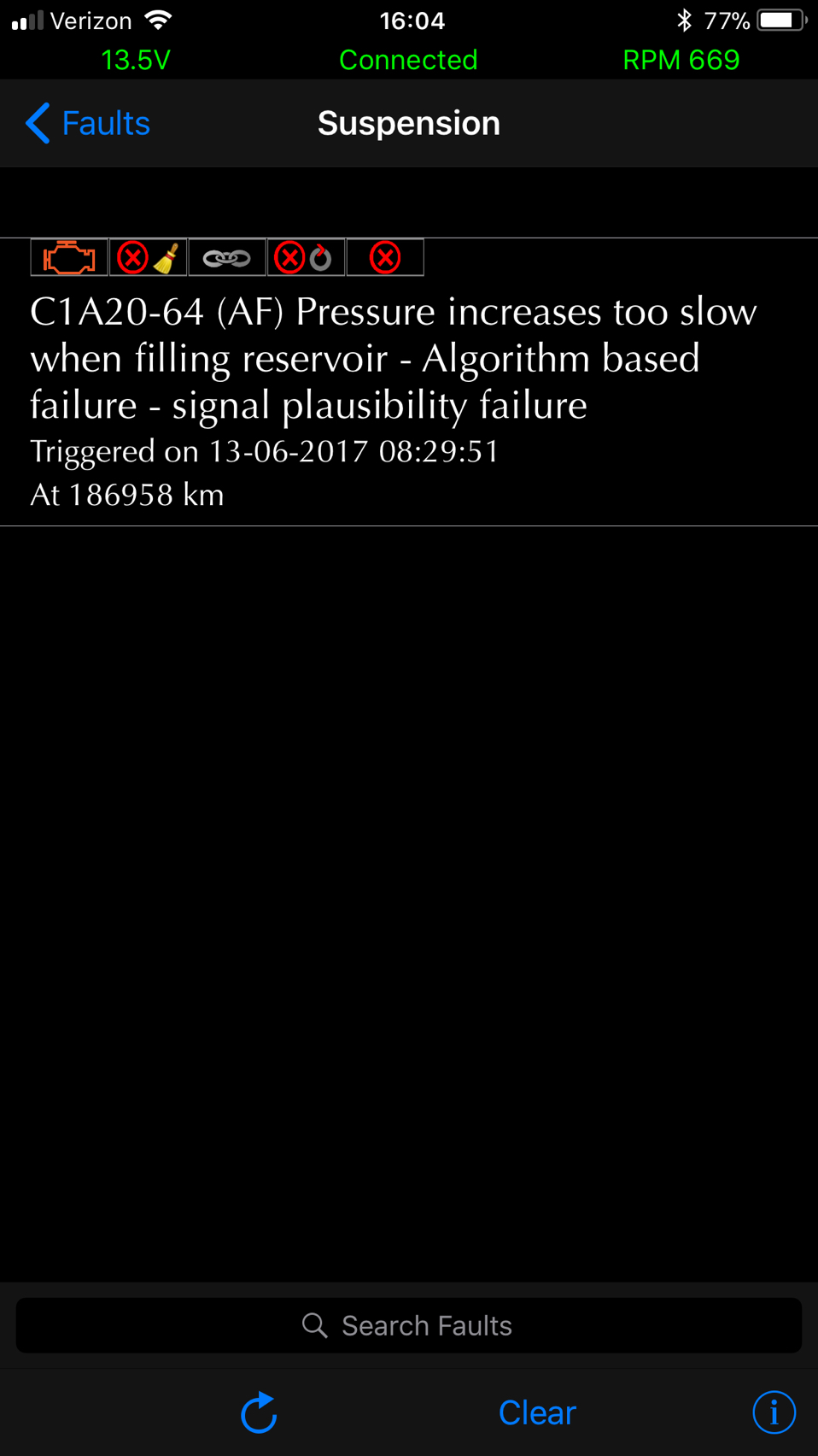

Curious if anyone has experienced a similar code that can give me an idea of what I’m facing . Entirely new compressor, cap leak, etc.

While not common, the air tanks can corrode and begin the leak causing a slow refill and extra compressor cycles. Do a good visual on your tank... also check your fittings for any obvious problems.

I had the same error when the pump was failing. Had overheated and couldn’t build pressure. Used AMK pump and error code hasn’t returned.
