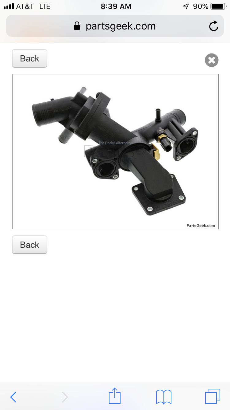

Which is the cross over you are talking about? Do you have a picture?
Old Jun 17, 2019 | 10:40 AM
abran's Avatar
Posts: 6,919
Likes: 794
From: Huntington Beach CA
Old Jun 17, 2019 | 10:51 AM

Ah ok . Yeah I have check that. My only other place it to remove the water pump pulley and visually see if the water pump is leaking or not. The only other thing I could think of was removing the throttle body housing and checking under the intake manifold for coolant build up. When saying something more serious are you think it could be a head gasket? I checked around the exhaust manifold and engine but could not visually see anything. IF it were leaking into the cylinder wouldn't I have over heating or misfire issues?
