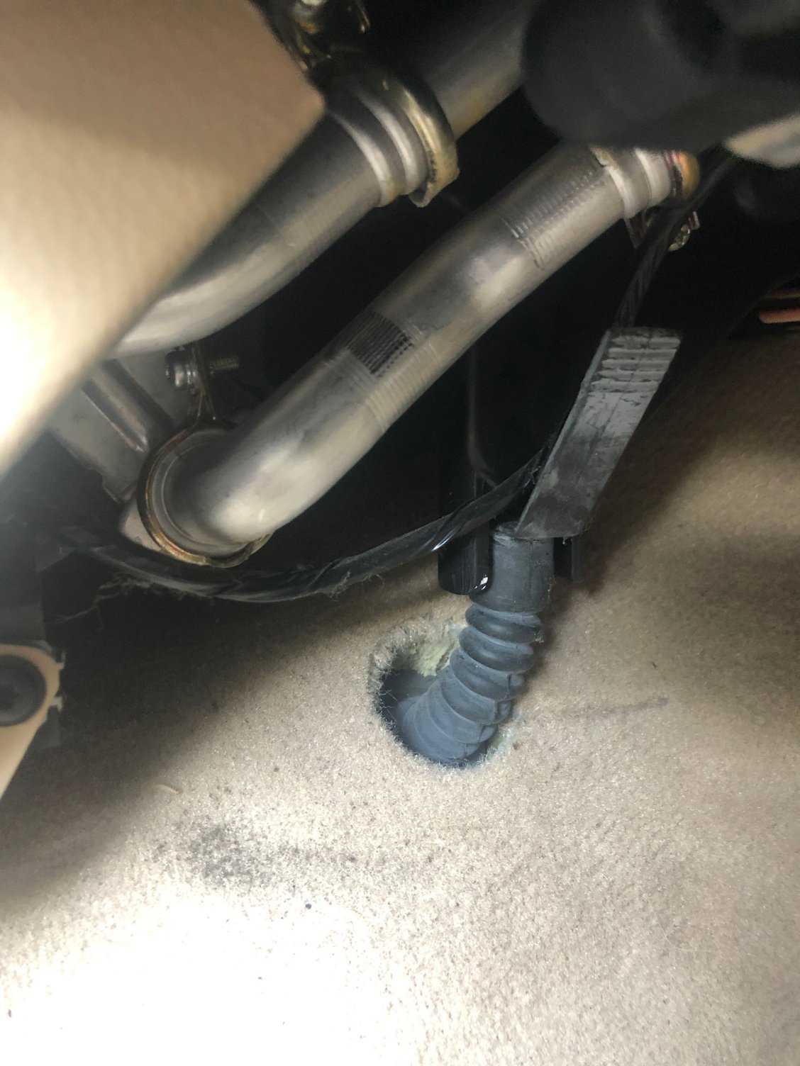

Thanks for clarifying. Attached are the drain tubes I checked on both driver and passenger sides. Are these the drain tubes you are talking about? One of them had a lego wedged in it.

Yes. If you pull em and nothing comes out, then the sloshing is not from the box being full of water or coolant.

Thanks. Yes, totally dry. Issue is farther up in the system.
