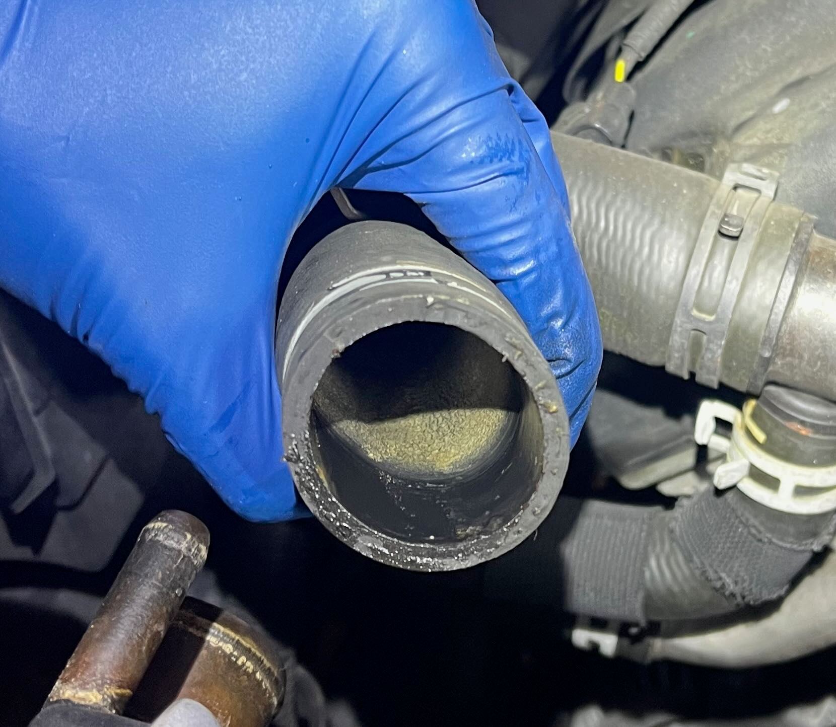

Hoses - replace? These are original. They don't feel particularly soft, but I see some build up on the inside. I have no experience to know if this is normal.

Hoses are not quite a milage thing, they age once they get put into service and degrade no matter what. That build up is pretty normal. I did all my hoses less the heater core bit and was in it for about $300. Which is not bad. I have a thread that goes over the hoses I used and the brands I went with.

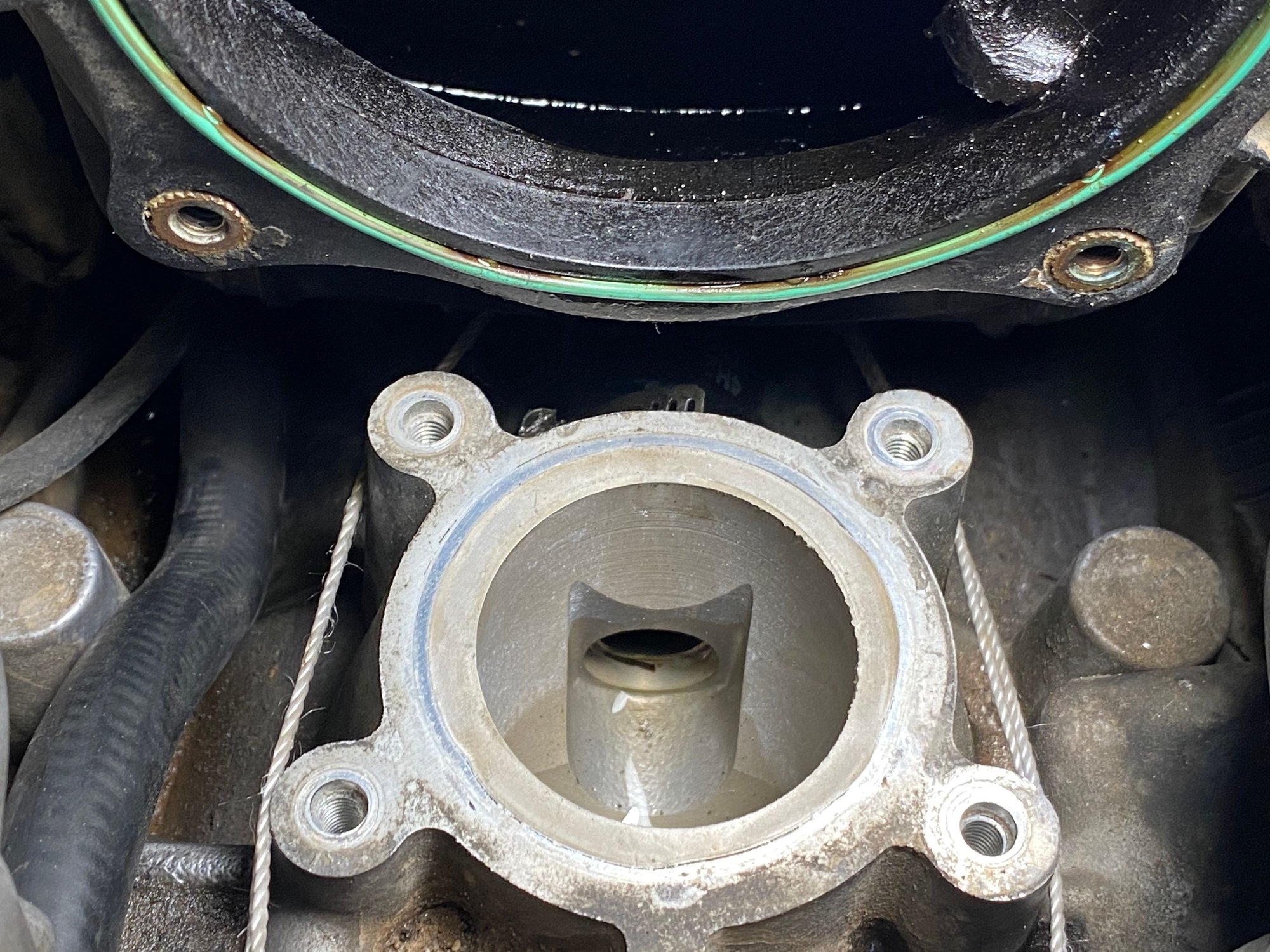

I cleaned up the gasket area of the block with a Scotch brite pad and brake cleaner. I removed some of the inner ring of off-white material while I was cleaning the gunk around the outside area. Should I be removing that entire inner ring of material or does it matter? It feels smooth. I didn't think the shop manual called for any gasket maker, but I’m actually not sure. Keep in mind I have never cleaned off a gasket surface in my life Thanks!

Radiator flush is really good to use before doing work like this, it will remove some or all of the scaling. In theory there should be none tho, it is sometimes a sign of incorrect coolants or water being used at some point. But I have seen it when coolant is used well past its life expectancy, which for the good ones is five years and for the low grade stuff just a year or two. I would think the scaling you have is probably not a big deal, but the issue is thermal transfer of heat which it can inhibit. If you are at all worried, you could push radiator flush or other stuff in after you button all back up and use distilled water. Run it for a couple days then flush with distilled water and replace with coolant.
