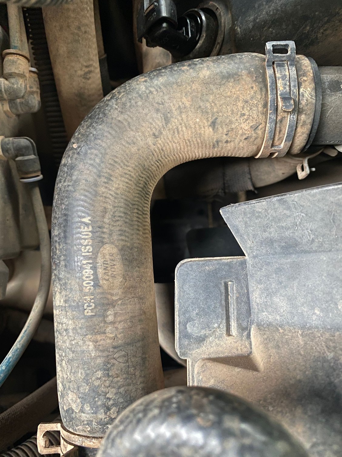

Upper radiator hose:
As long as we are talking about the upper.... My new replacement was Gates, a reputable brand. But I did not like the hose, it seemed to have an odd kink in in. I even removed some hoses to shorten and stretch it a bit. It was just not something I liked about it and ordered a Eurospare part to replace it because I could get it quickly and it had a MUCH more OEM look to it, including the texture of the hose. Would not be surprised if it is a repackage. Unlike the gates, the Eurospare came with all new clamps.
Original OEM hose installed:
Gate on left, Eurospare on right:

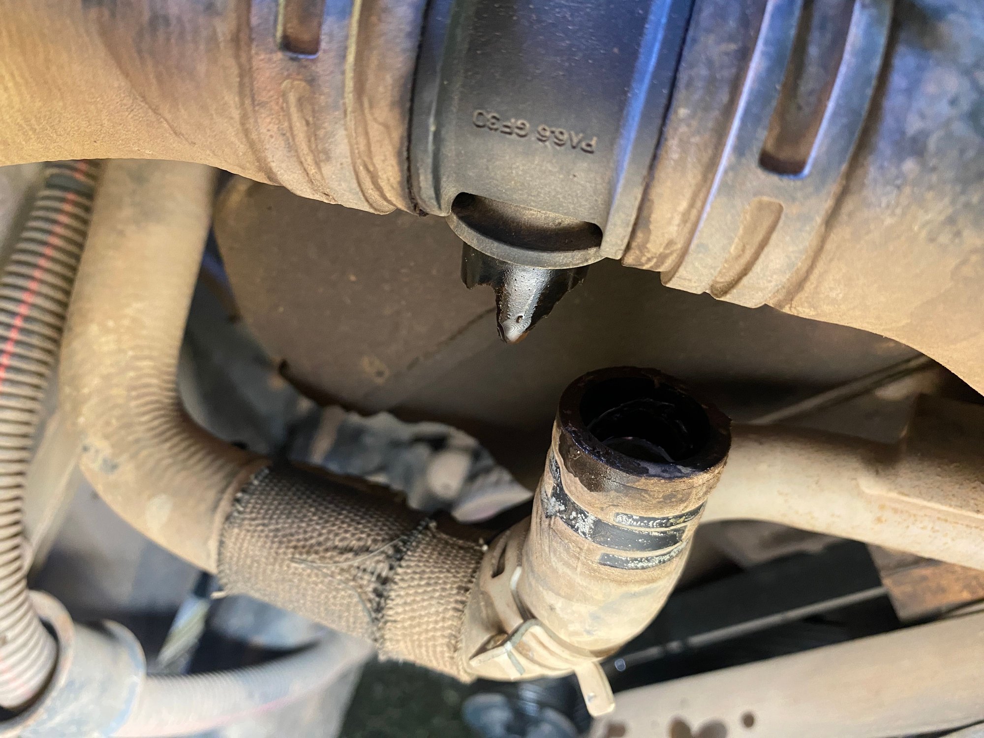

Another tip. If you are doing the rear heater hoses, careful if you use the original clamps. You want to be certain that the OD of the replacement hose is the same as OEM. The clamps are stamped 25, which I assume is 25mm. I bought some Sioux Chief hose and it had a thinner wall so the clamps did not put on enough pressure to keep a good seal and I had leaks. I had only done the 90 degree hoses from the rear heater core. You can get OEM hoses for about $80 USD but I went with some nice generic 90 degree hoses from Amazon. $24 for a pair and they were much thicker.
