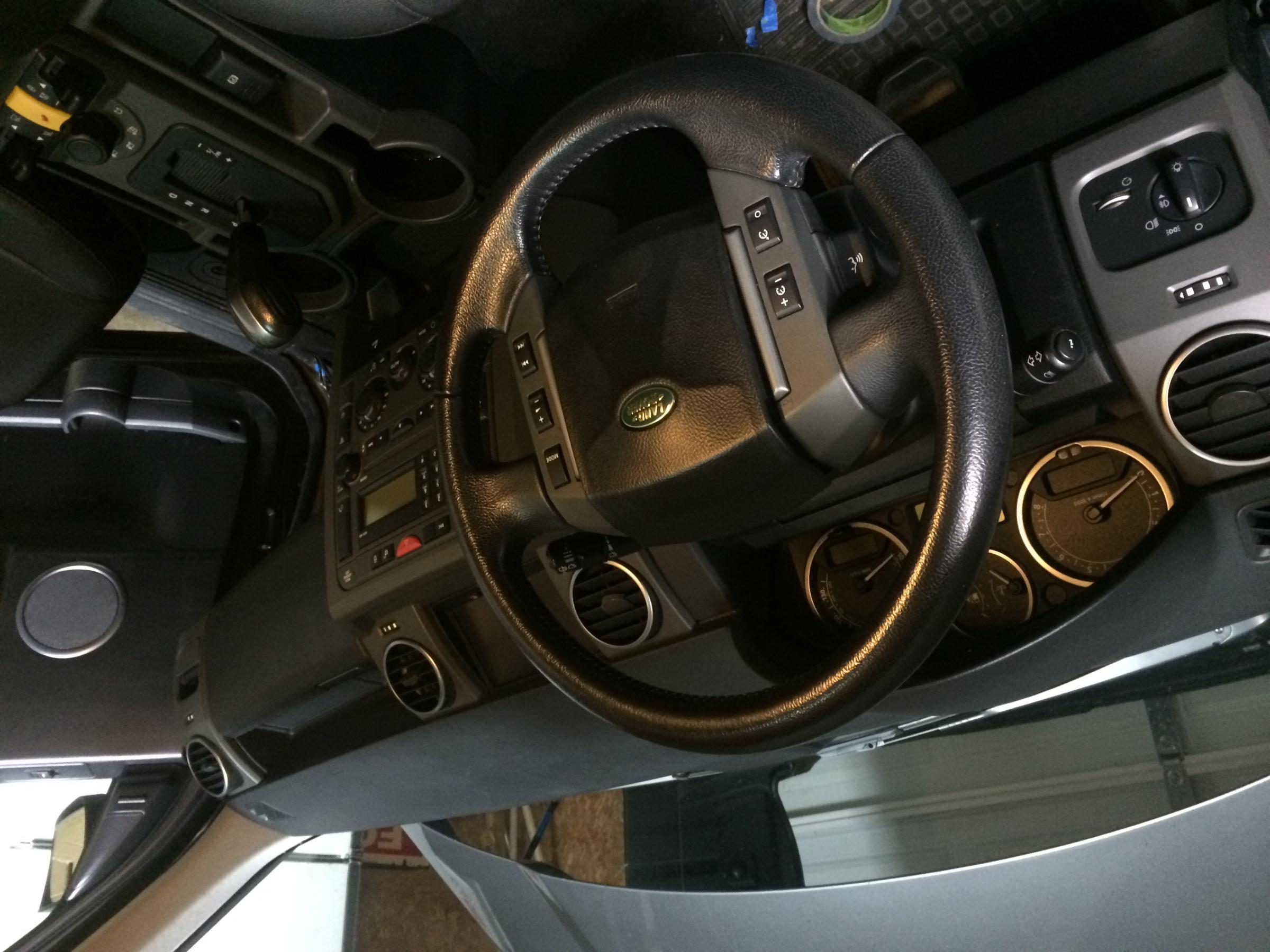

Finished installing the replacement. Sadly, the only apparent difference between the old and new dashes is the instrument panel speaker area near the center of the windshield. The sunlight load sensor has a slightly different housing. Other than that, the dash material itself feels the same. We'll see how long this lasts.
That being said, it looks great. It's nice to not have to stare at those annoying cracks every 10 seconds. I cleaned everything as I went. Even the carpets under the seats and footwell areas. Ended up taking me around 10 hours this weekend with plenty of football and beer breaks.
Ps: I have no idea why my phone uploads photos upside down lol. Yes, it is annoying.

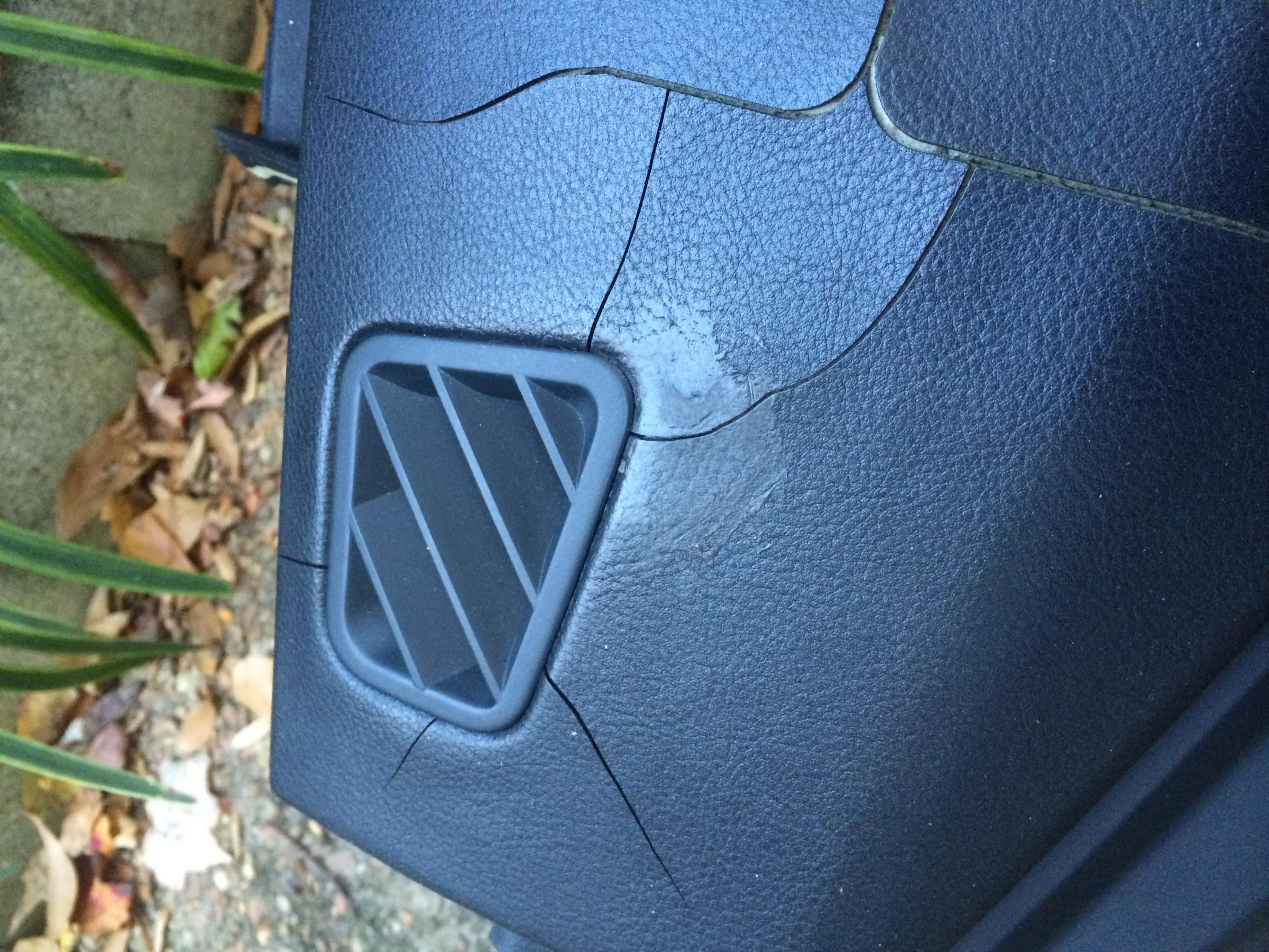

Originally Posted by unseenone
How long is it taking to do the job, it looks too simple in the manual?
Around 10 hours over 2 days. The manual is nearly useless. I posted the procedure earlier in this thread. Basically, everything from the front dash and center console has to come out. That includes the drivers, center, and passenger dash structures. All electronics and the center console have to come out. It's not that difficult (at least not in a mechanical sense), but is time consuming. Keeping track of the 1,000,000 screws and fasteners that have to come out is the biggest thing. I'm crazy about putting screws back.
This is what the dash looked like...
