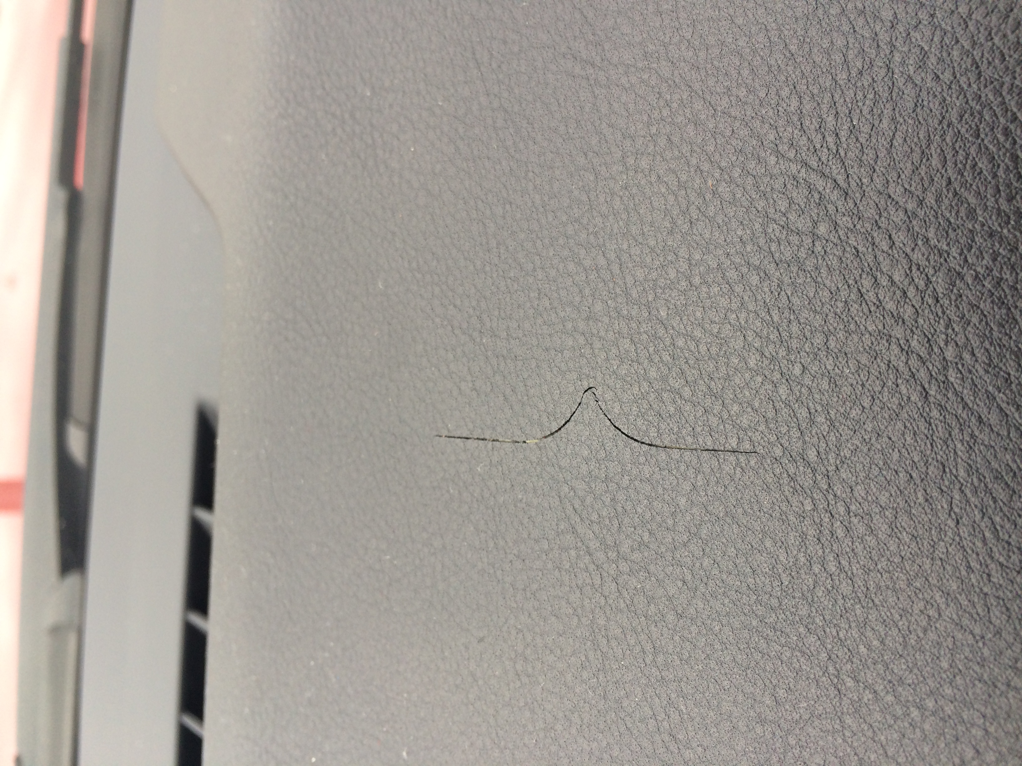

Dashboard just started cracking at the left edge of the passenger airbag.
2006 LR3 HSE.
Any suggestions on stopping and then repairing the crack?
Thanks.

Very common LR3/RRS issue. Some people install dash mats, I live in TX and mine has two small cracks around the airbag. I make sure to use a sunshade when I park, but unless you replace the dash I haven't heard of a way to fix it yet.

There is a kit by permatex for fixing cracked vinyl, i tried it on mine and made it worse, so I picked up a dashmat from seatzmfg.com in tech black I think the material was called,
Looks "ok" better than the crack

Most vinyl/leather repair kits on the market are not worth the time and investment but these guys seem to offer a product that should work. Where the repair uses heat to set and bond the product, due diligence should be exercised working over an air bag.
https://leathermagic.com/deluxe-vinyl-repair-kit/

Mines all cracked, dash mat

Did the exact thing as packratt. Tried the permatex YUCK! Did the dash mat in the tech fabric. That or $700+ for a new dash.
