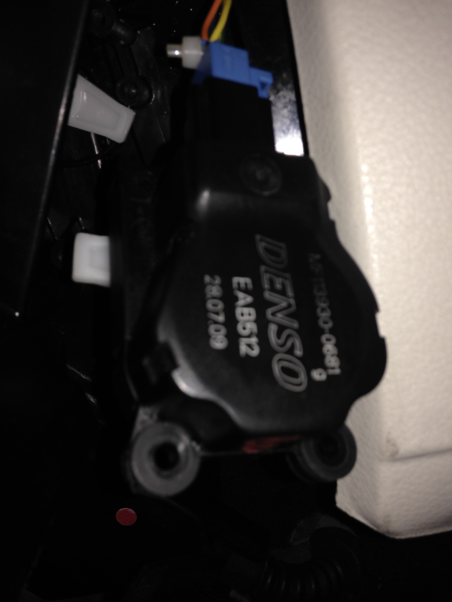

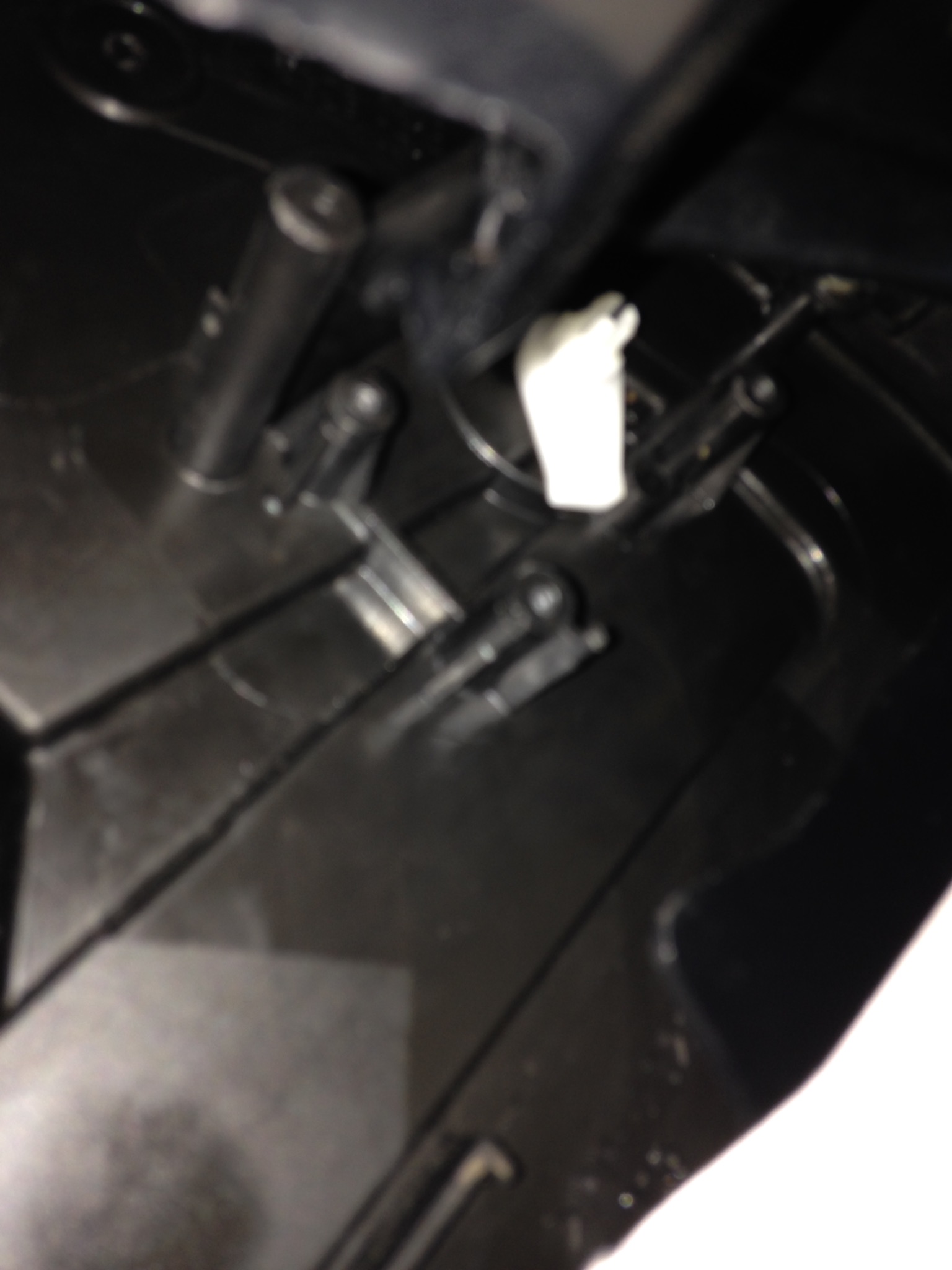

I can only give you my experience. It is pretty easy to access and remove from the hvac box. Remove the footwell cover that is below the drivers dash Once that is out you will be able to see the Servo motor. There are two. The lower one is the easiest to access and is the one that controls the blend door for the drivers side heat. I assume that you are getting heat on the passenger side. Unscrew the motor. Keep it plugged in and turn on the hvac and adjust the drivers side temperature. When working, e motor should move that blend door only moves about 90 degrees. I
The default position is for cold air to the drivers side. There is a small post that sticks out of the heater box. That post is connected to the blend door. You can use pliers and turn the post counterclockwise about 90 degrees. It will fall back to the default position when you release it. If you turn the fan on to position three or higher the blend door will remain in the heat position. When the fan is turned off you can hear the blend door fall back to the default position. There is a white plastic piece that is about an inch long. It connects the Servo motor to the post on the heater box. I found it easier to manually flip the blend door using the plastic piece I will try to take some photos for you. Phil

One more thing that I forgot. There is a front cover below the steering wheel. Pull that off. Two clips at the top and the bottom pulls up and out. Not the white piece on the motor and where it is placed on the heater box. Good luck. Phil
