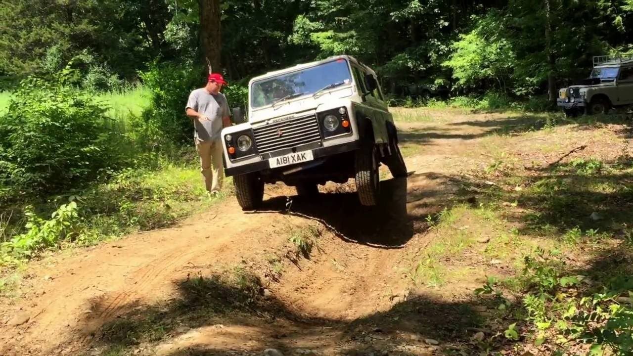

As to when it would be supported by 2 instead of 4 tires, any Land Rover challenge course or off road centre has a portion with opposing holes in the road to demonstrate the articulation of the vehicle and balance it on 2 wheels diagonally. Roughly like the photo below. Get anywhere close to the GVWR with this car and do this, you would want that safety margin. I would value safety over comfort all day every day, especially for family.
