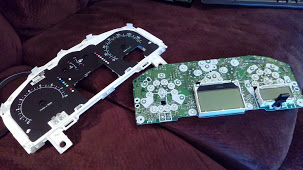

Old Aug 19, 2014 | 07:00 PM
BonzLr3's Avatar
4wd High
Joined: Aug 2014
Posts: 9
From: Knoxville TN
Default LR3 starting issue fixed
Hey guys, this is my first post but I wanted to thank Bmwrovers for helping me identify my issue on my 2005 LR3. I was having the same issue where the car would randomly not start (Temp gauge goes to dashes, climate goes out, radio says shutting down and hazards would turn on), I could bang on the dash board and it would start and everything would return to normal. Today I finally took the dash apart and started to wiggle the harness on the back of the cluster, I found it would make the issue return. I know the can bus wires communicate with the dash, and can cause these weird issues. So I pulled the cluster completely out and checked all the solder joints, I found where the plug attaches to the circuit board had just a small amount of solder on each terminal. I pulled the solder iron out and re-heated the terminals (adding a small amount of new solder) and put it back together. After reconnecting the dash, no issues everything is back to normal even after I wiggle the plug. This issue can be frustrating to diagnosis and BMWrovers got me started on the right path, I hope this helps for people having this issue.
