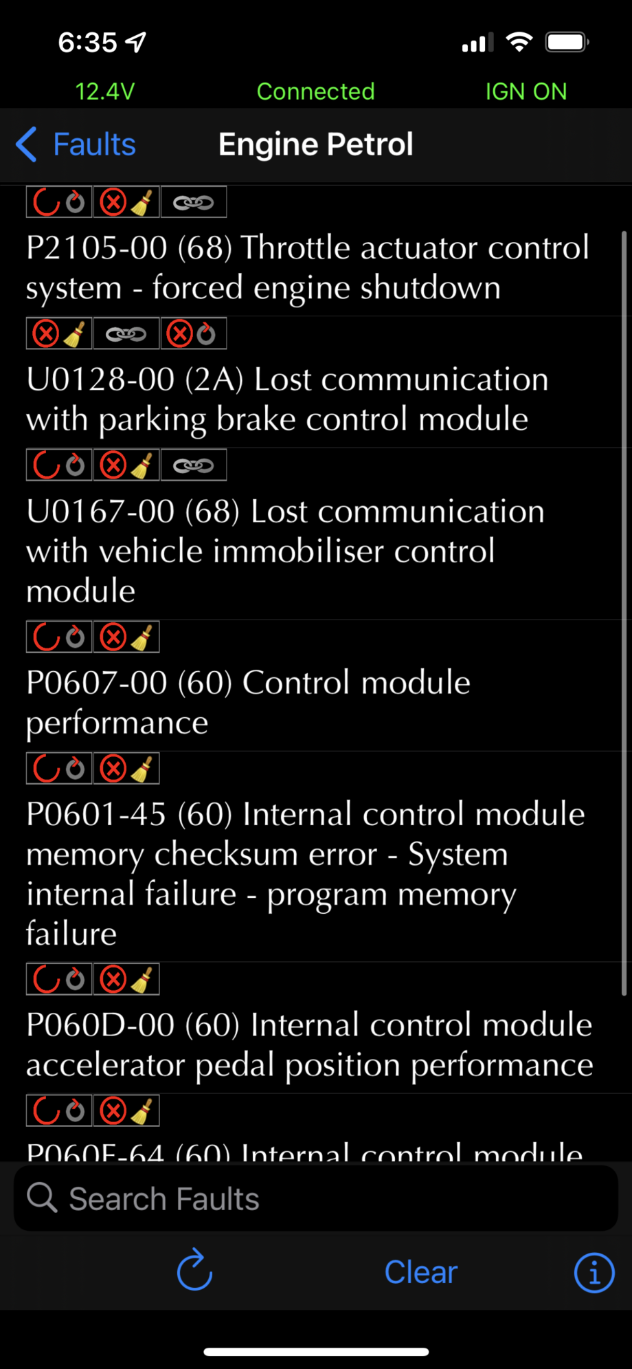

So this nice error code came up tonight. Followed by HDC off. Idled rough and then Went into limp mode and I hobbled to find a quite place in the parking lot to figure things.
Turned it off and back on. engine fault briefly
flashed then everything was back to normal.
Ran the gap tool and here is the plethora of errors. Cleared them. No faults after the clear.
many ideas here?

How many of those codes were set when you had the problem? A lot of them are probably just noise, so you need to look at the date/time they were set. Not knowing that info, the throttle body and accelerator codes stand out for me. Personally I'd start with cleaning the throttle body and doing a relearn on it via resetting fuel adaptations, then monitoring for awhile....

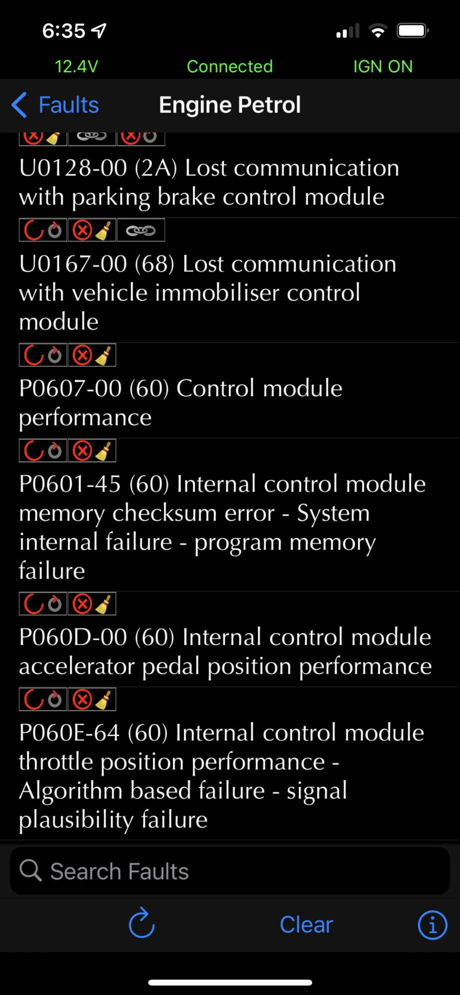

All of the P060 codes point to;
ECU
Pedal Assembly
Throttle Body
Or any of the wiring, grounds or connections associated with these three things.
I see the voltage with the ignition on was 12.4 - Just curious, what was the outside temp when you took these readings?
As stated above, clear the codes, but this time set the GAP tool to only read test failed since last clear to clean up the list a little.

Ok. Where would you suggest i start? FYI - not sure, on GAP, where i change the setting as you have indicated.

According to gap…
13.8 while running / 12.4 sitting.
maybe alternator?
ill try the multimeter tomorrow….
