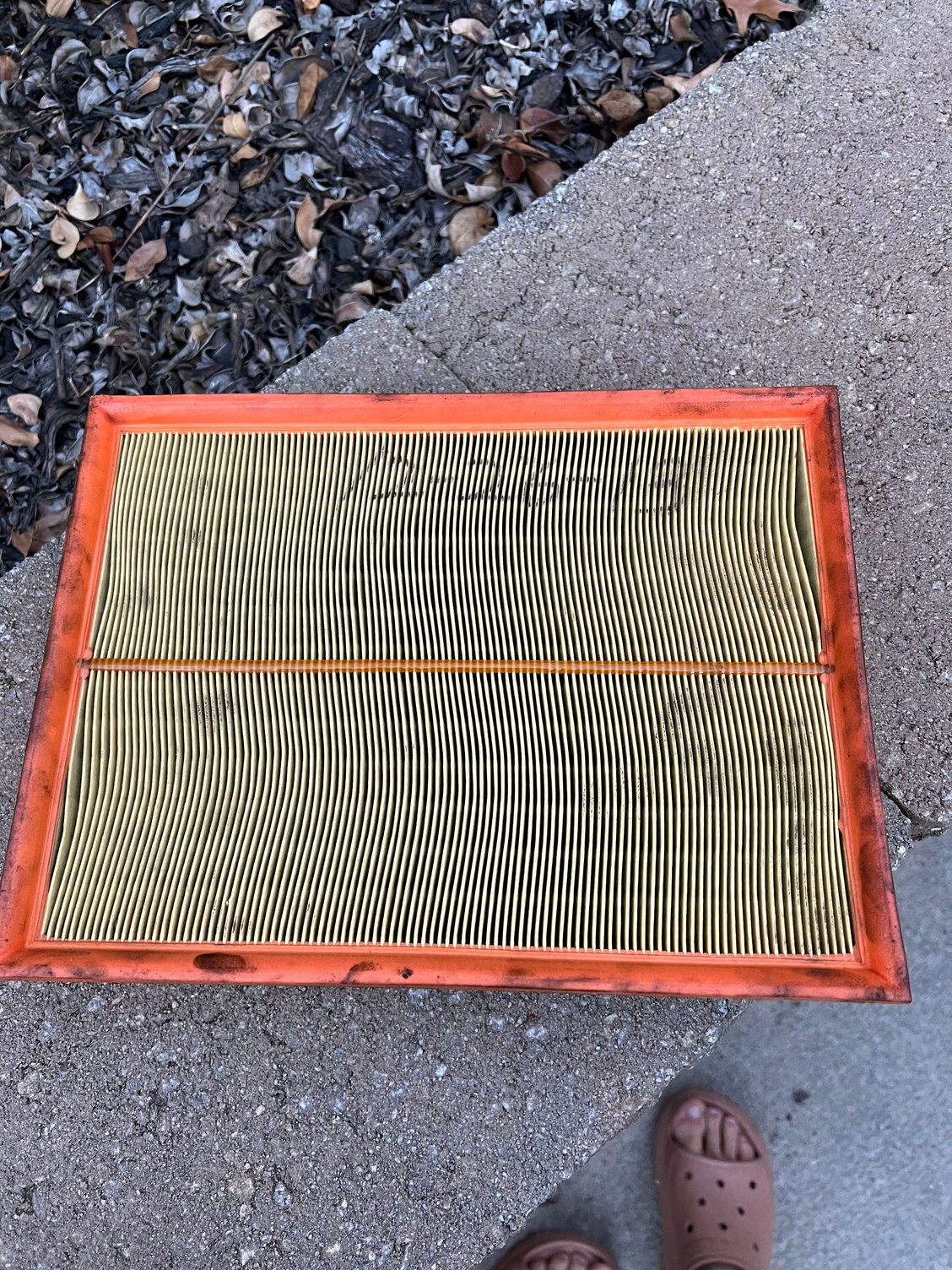

Just updating in case it helps someone else later. Started tinkering tonight. Took off the air filter cover…I was shocked to find a filter dated 12/26/2013.
so, that explains some things. No idea how that could ever happen on a vehicle with service history. Maybe swapped at the auction yard? No idea. Anyway….

so I just ordered all new coils. Going to replace the remaining 6 plugs, and 8 coils. New air filter. Cleaning up the MAF which is a 2020 and looks okay. Which is why I can’t believe no new air filter. Throttle body also cleaned and looked fine. Will also run BG44k and report back.

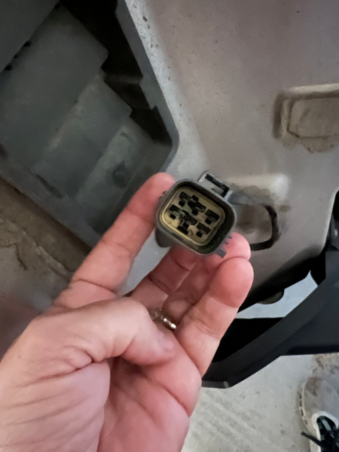

4. replaced brake light switch, and found a ton of corroded bulbs, connectors, and burnt out bulbs in the taillights and license plate lights. Didn’t even realize we had bottom fog lights because they were full of water. Cleaned every connector with contact cleaner. Sealed housing. Reinstalled. We have light!

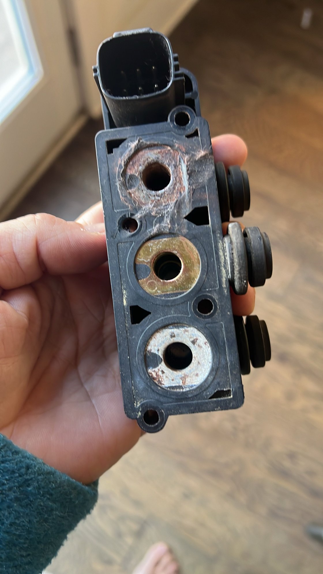

5. dismantled the EAS system. Bought o ring kits for compressor and valve blocks from 4x4 air seals. Bought a new desiccant drier from X8R with upgraded drier cover. Cleaned and serviced compressor. Old drier full of dust and hard filters. Desiccant seen in all the lines. Removed all valve blocks. Rebuilt front and center. Rear had a ton of corrosion on the left and right solenoids. Opted to replace. Used shop air compressor to blow out lines. Lubricated ride height sensors with spray silicone. Reinstalled everything. Car now goes into access height without any faults. No faults on driving, all modes work as expected.

Rear valve block. Left and right should look more like the center. They were totally corroded.
Suspect some arcing through the brake system because soot here and also in the brake light switch.
