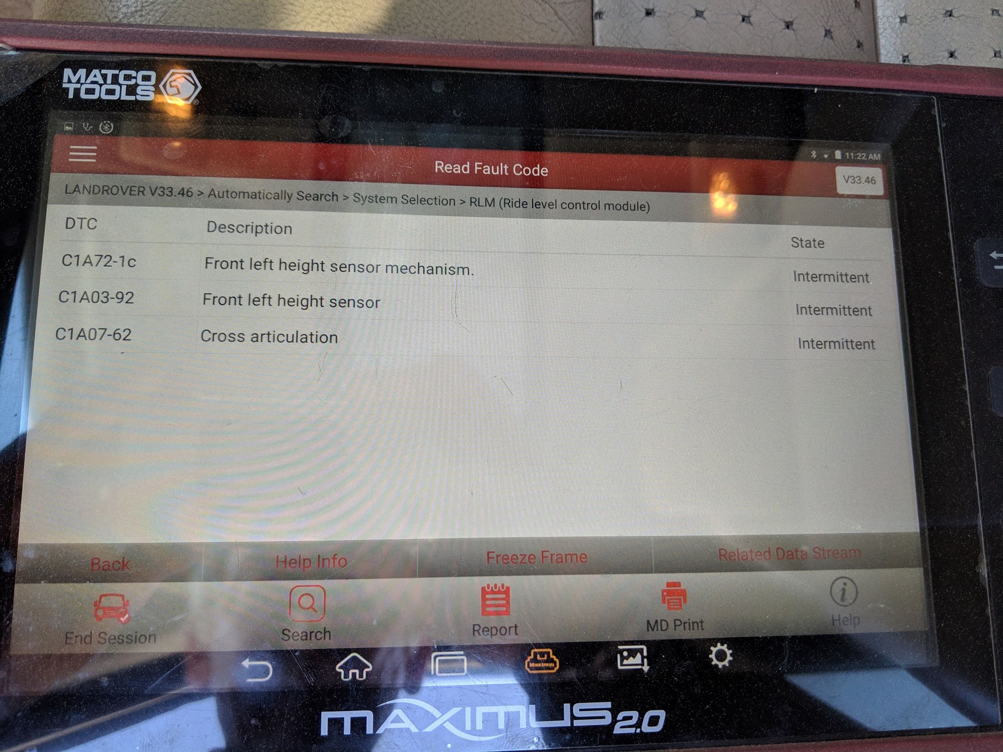

...but I'll bet on a bad calibration due to either a failing height sensor or a wiring issue.

Default FAult codes
These are the fault codes
I think we need to replace the front sensor...you agree?

houm_wa wins a cookie! Nailed it!
But as he said, check the wiring, clean the connection, etc. Lastly replace the sensor.

Thanks. Any idea what the cross articulation code means?
