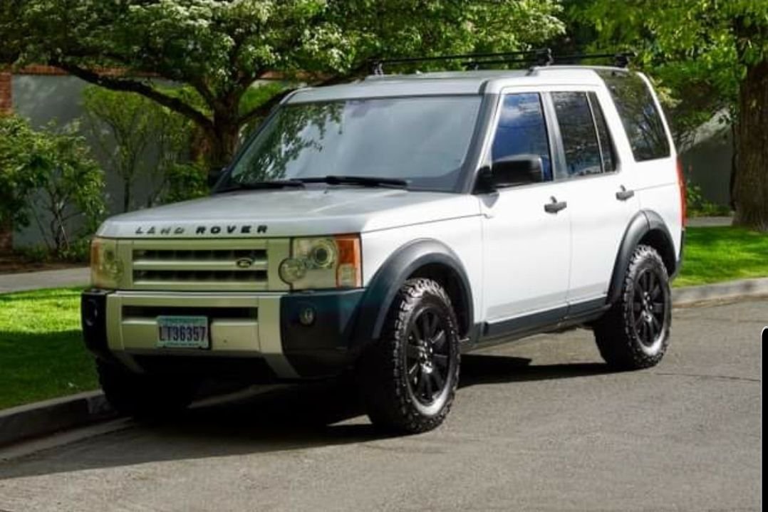

The oil pump failed at 135K miles in my 05 LR3 4.4L in which damaged the motor beyond repair unfortunately. So I'm putting in a used motor with 65K miles out of a 06 LR3. Is there anything I should change before a swap is done? I might obviously change the oil pump and oil cooler since that's a concern and maybe new chain guides. Any recommendations of changes I'd like to hear them!
