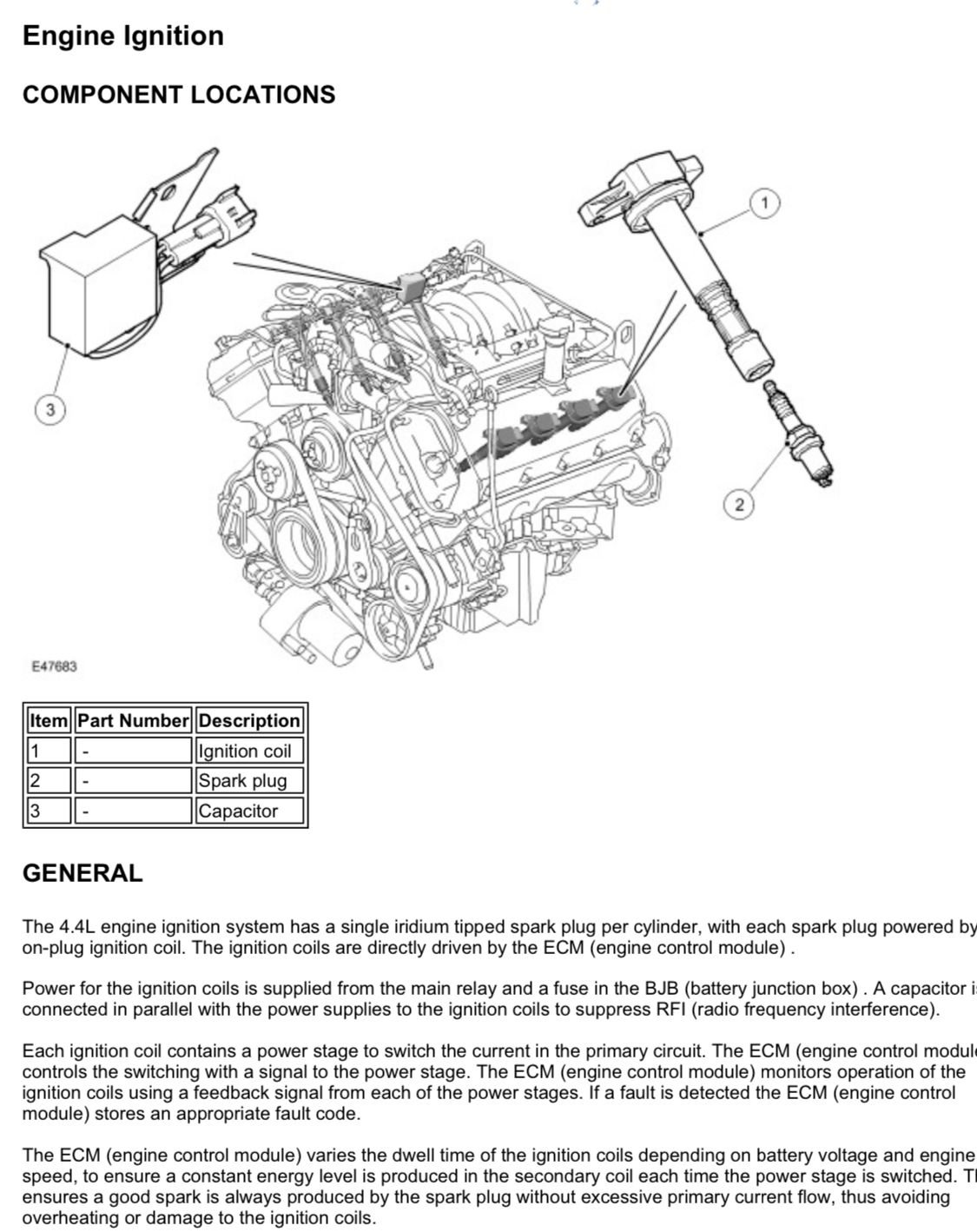

The ECM controls the coils directly. If there were an ECM issue, you should be logging an ECM specific fault.
The only shared component of all coils/plugs beyond the ECM is a capacitor that is wired in parallel to prevent radio frequency interference. Perhaps that failing would cause misfires.
First thing to come to my mind when reading your symptoms was throttle body. Rough idle, but runs ok under load. Usually cleaning fixes it, which you’ve done. There should be a way to watch throttle body position live data along side misfire counters for various cylinders, that might give you more insight.

I think I read that if the RF Capacitor fails you can get a no-start issue. On the other hand, you can disconnect it and things will be fine; it's not needed.

As I understand it the LR3 has no distributor, the controller is the ECU. There is a grim possibility that that is the issue.
Nonetheless, coil replacement was todays project. I began with two coils, replacing cylinder five and seven. The result was misfires on only two cylinders, three and eight I believe. While I can not begin to understand the cause of that, I thought I was on the right track so I sourced 8 new coil packs, in addition to the two I could find this morning.

Just fyi, the rf capacitor can be bypassed, but not disconnected.
