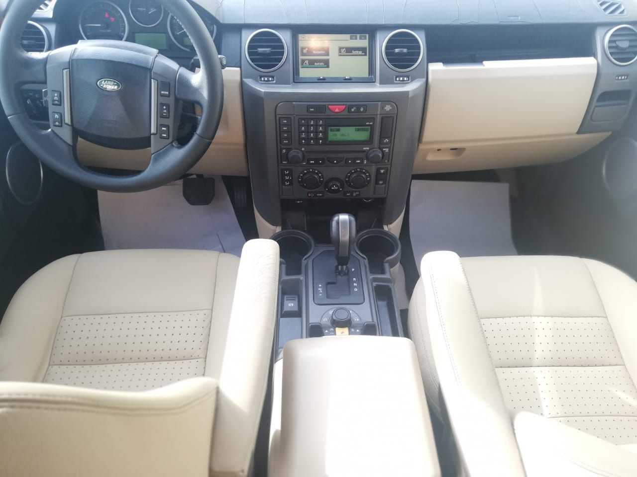

An update on this, with a twist. It seems that it is not the exhaust leaking fumes, but rather the A/C that is releasing the CO2. (BTW, it's not monoxide, as I mistakenly wrote above. The device measures carbon dioxide.)
The recirculating has a faster and higher concentration, but also the outside air brings in the CO2 - but not when the A/C is switched off.
Why would the A/C blow out gases that make you sleepy?

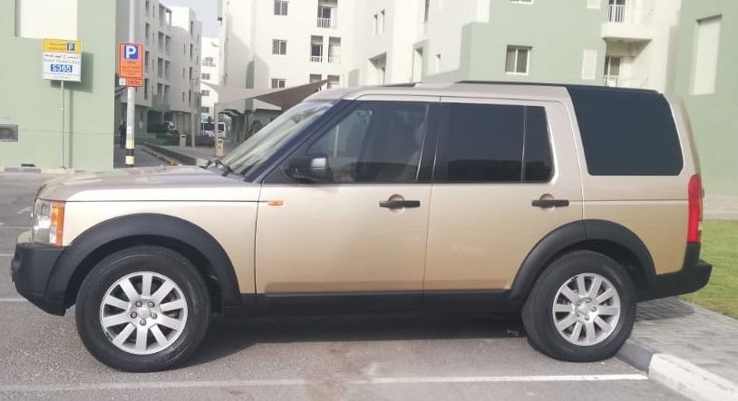

The vehicle is in great shape, BTW, looks and drives like new. Except for the dash...
