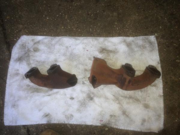

Being that the manifolds are as old as the hills check them for square. Flange faces are probably twisted just enough to produce leaks and clamping them down cold isn't going to pull them tight to the block. Check the exhaust manifolds for cracks too, doesn't take much of a crack to make the noise. Check the heads for any left over exhaust gasket. I use a table sander (belt/disc) to square up flanges, they do deform and runners twist. You might also have a head gasket leaking, normally it would be on 6 - no coolant ports. If you need a good used manifold contact Paul Grant in my sig.

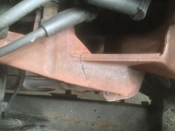

I have also ran into a few cracked manifolds as well.
Me too.
