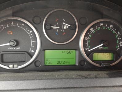

In town, I usually got about the same or maybe 1 or 2 mpg better in my LR3 than the D2, 14 or sometimes 15 mpg.
On the highway, depending on wind which seems to affect the LR3 a LOT, I've gotten as high as 20 mpg:
