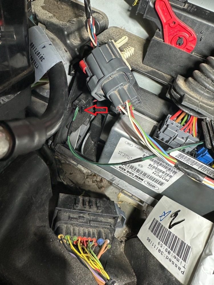

Thru my ongoing SAGA with my LR3 going into "Crash Mode" (flashers on, system shutdown, U codes etc) I attempted to remove the ECM to clean it up, major failure.
But in removing the Transfer Case Module I noticed this apparently spliced wire. When putting the Transfer Case Module back in, I noticed this wire actually ran up the loom that the cover for that area snugged into but exited the area to go to its connector, which would be pinched to go out of the cover from the loom to its connector.
What is it?

BTW, I pealed back the terrible electrical tape wraps in the two spots and there was no splices. Is this normal on all LR3's?

Just noticed this wire really weirdly wired in and was wondering what it was.

The green wires might be fore the cooling fan. Yes, there is a tiny little fan for the ECUs in there.

well, I couldn't get one of the screws out so didn't remove the ECM so I didn't see a fan. Makes sense. If that little stupid fan went out and is causing the ECM to over heat all this time, I'm going to be pissed.

It would throw a code if bad.
