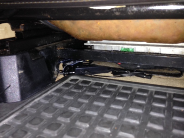

I want to share this solution that has worked fantastic for adding bluetooth to an older Rover that doesn't have it.
Skill level: Mega easy - 15 minutes
Tools needed: A credit card
This awesome little device is the brains of the bluetooth addition. You can skip tracks, pause, play, and fire up Siri with it. It has a sticky back so you can just stick it to the dash and the wire is so thin you can see from the attached photo I was able to smash it into the thin seam alongside the radio using a credit card.
Amazon.com: Kinivo BTC450 Bluetooth Hands-Free Car Kit for Cars with Aux Input Jack (3.5 mm) - supports aptX: MP3 Players & Accessories Amazon.com: Kinivo BTC450 Bluetooth Hands-Free Car Kit for Cars with Aux Input Jack (3.5 mm) - supports aptX: MP3 Players & Accessories
I ran the power and aux under the rubber cubby thing just in front of the cup holders, and towards the front passenger seat. I connected power for Kinivo and my phone to this cigarette power hub. I used the USB power on the bottom for the phone.
Amazon.com: 5 in 1 Car Charger - 4 port 12V DC Auto Socket Duplicator Plus USB Port: Car Electronics Amazon.com: 5 in 1 Car Charger - 4 port 12V DC Auto Socket Duplicator Plus USB Port: Car Electronics
Next I connect the audio cable from Kinivo to this device. You need it to remove noise from the car's electrical:
Amazon.com: PAC Ground Loop Isolator for 3.5 MM Applications: Automotive Amazon.com: PAC Ground Loop Isolator for 3.5 MM Applications: Automotive
Next connect this Boostaroo device to the above ground loop isolater. Its a tiny amp which was necessary because the aux input on the Rover stereo was very quiet. This thing packs a decent punch and is clean sounding despite its size. Connect the Boostaroo cigarette power to the above
Amazon.com: UpBeat Audio Boostaroo Revolution R234-MC 12 Volt Powered Motorcycle and Car Audio Amplifier (R234MC): Electronics Amazon.com: UpBeat Audio Boostaroo Revolution R234-MC 12 Volt Powered Motorcycle and Car Audio Amplifier (R234MC): Electronics
Connect this 3.5 mm audio extension to the output on the Boostaroo and connect the other end to the aux input which you'll find at the back of the center console just under the rear passengers air vents. Also connect the cigarette plug to the power duplicator here.
Amazon.com : C2G / Cables to Go 13787 6 feet 3.5 mm Male/Female Stereo Audio Extension Cable Black : Stereo Jack Cables : Electronics Amazon.com : C2G / Cables to Go 13787 6 feet 3.5 mm Male/Female Stereo Audio Extension Cable Black : Stereo Jack Cables : Electronics
Shove the cigarette duplicator in between the passenger seat and the console. Its a tight fit but its nice because it stays put. I put the ground loop isolator, Boostaroo, and excess audio cable under the passenger seat out of view.
Total Cost: $126
This cost doesn't include the cost of the ProClip iPhone mount you'll see in the first attached photo. I can also highly recommend the ProClip mount. It was a 5 minute install, looks great, feels really solid, and provides fantastic view and accessibility. I use it with all the above for GPS and driving directions through the Rover's stereo speakers of course. These are the parts you'll need (second link for iPhone 5 with thin case only... if you have another phone buy the first mount and pick the correct cradle for your phone):

Attached Thumbnails Great solution for adding bluetooth phone and streaming music-bt.jpg   Great solution for adding bluetooth phone and streaming music-photo-1.jpg   Great solution for adding bluetooth phone and streaming music-photo-2.jpg   Great solution for adding bluetooth phone and streaming music-photo-3.jpg
