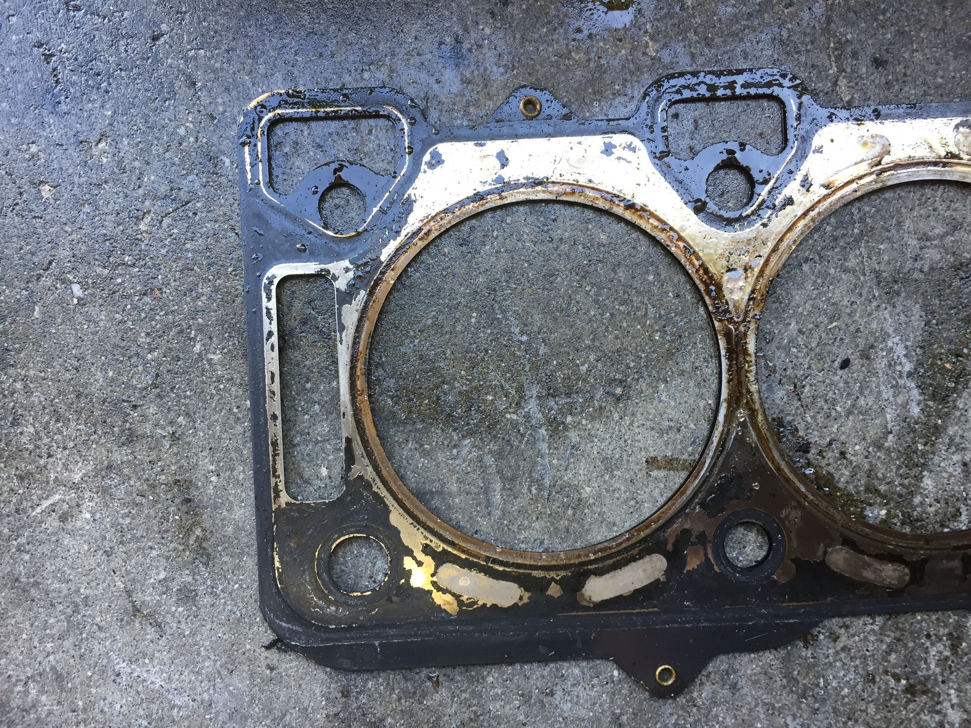

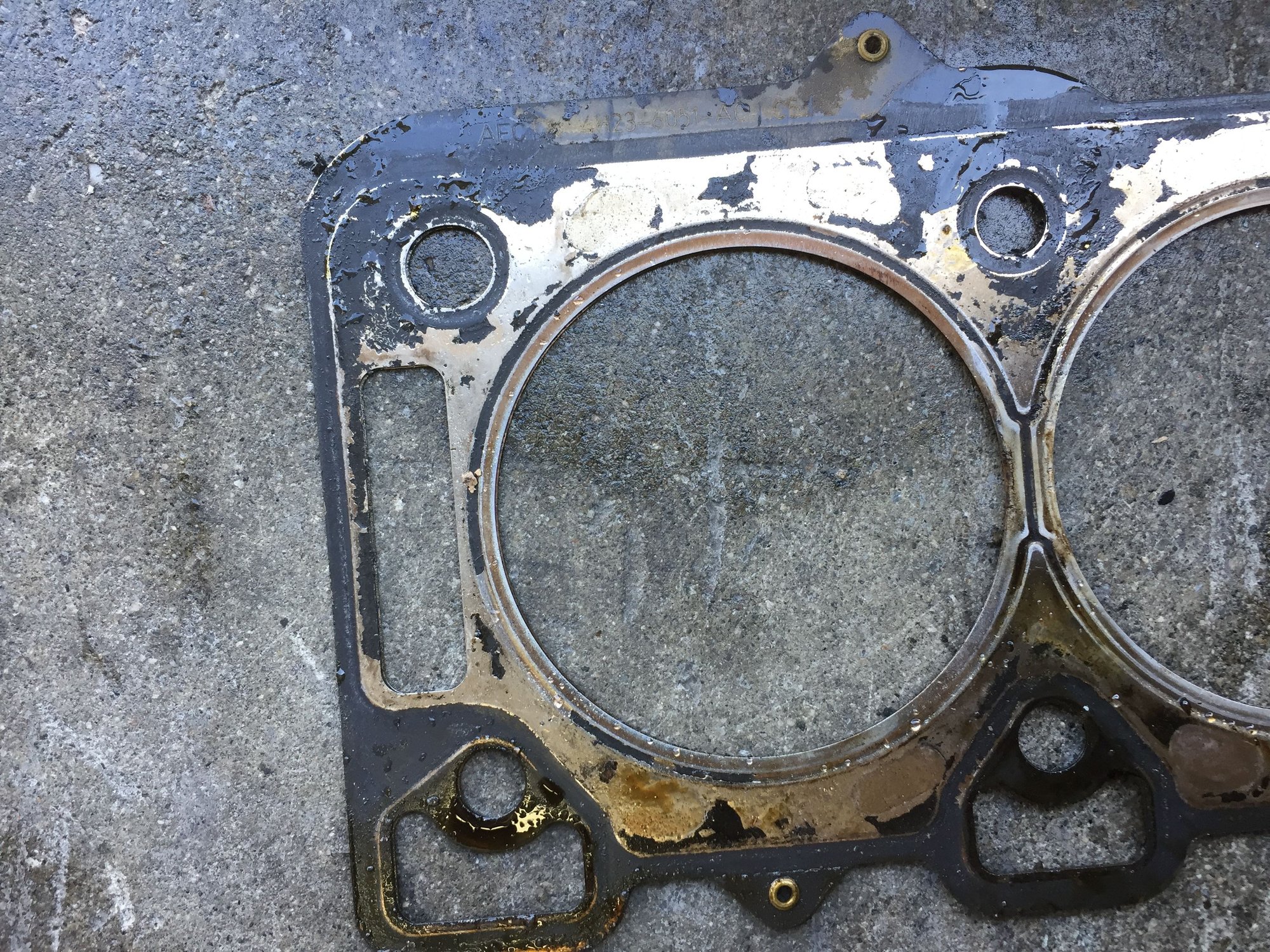

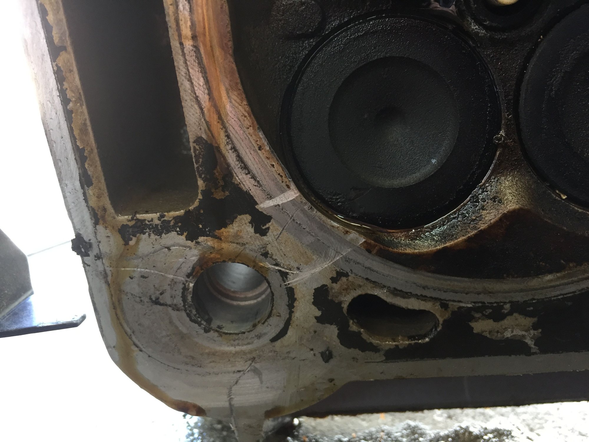

Default Heads off
Gasket looked fine on #7, but as these are metal gaskets I didn’t think I would find a problem. There were some marks on the head, but could have been made during removal.

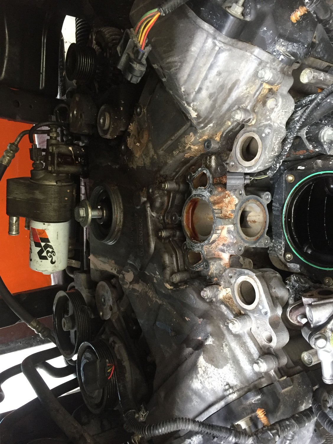

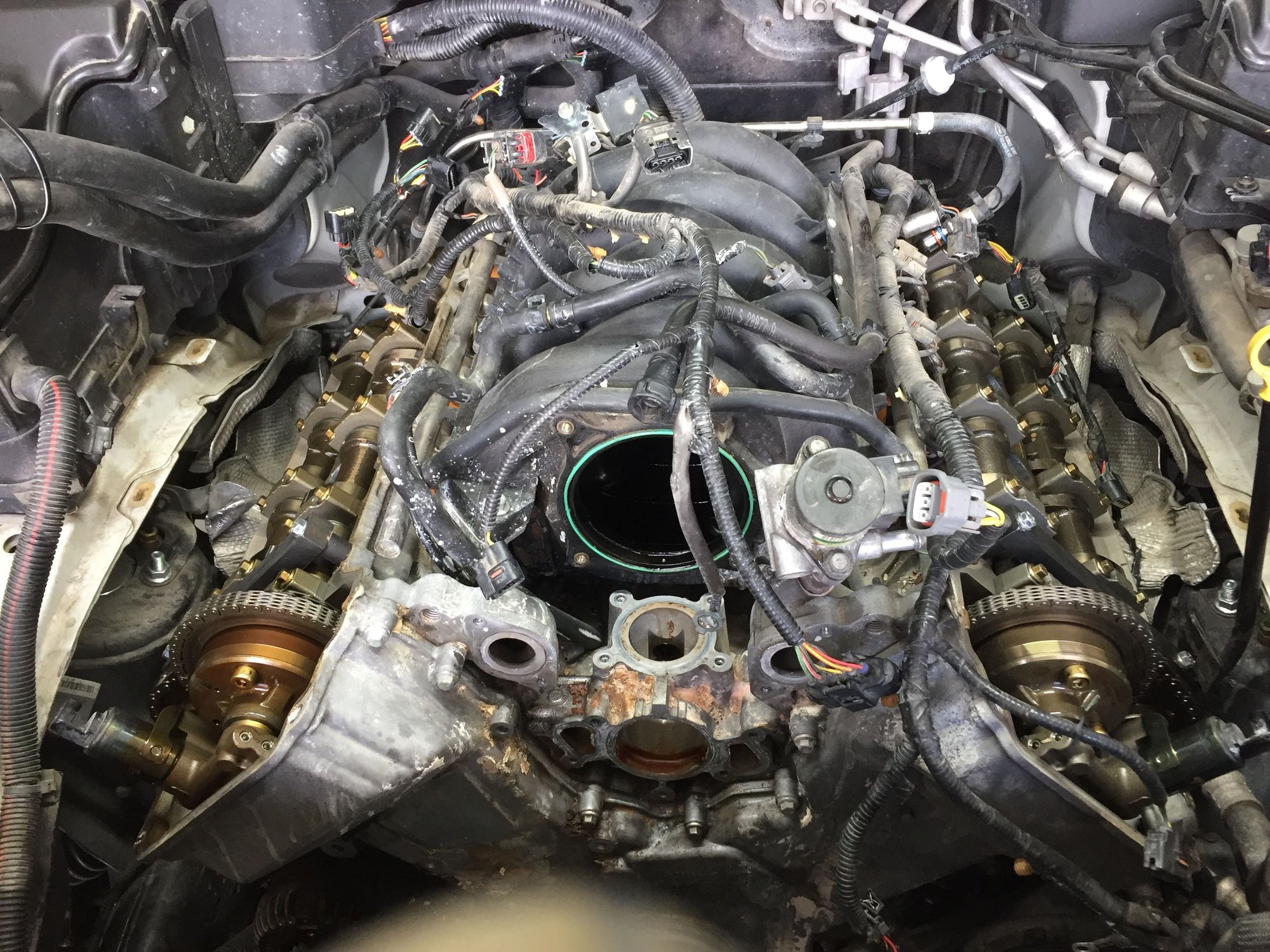

Looking at picture #2 and 3 now I know why I could not reach down or find an attachment of the coolant hose.I have changed all of them in the engine bay but that one, that connects to a bleeder TEE.Hmm.. How involving is to take an exhaust manifold ?

I believe you mean intake manifold. It’s like 10 bolts and all the injectors connectors. That is after the throttle body is off.
exhaust manifolds came off with and is going back on with the heads.
