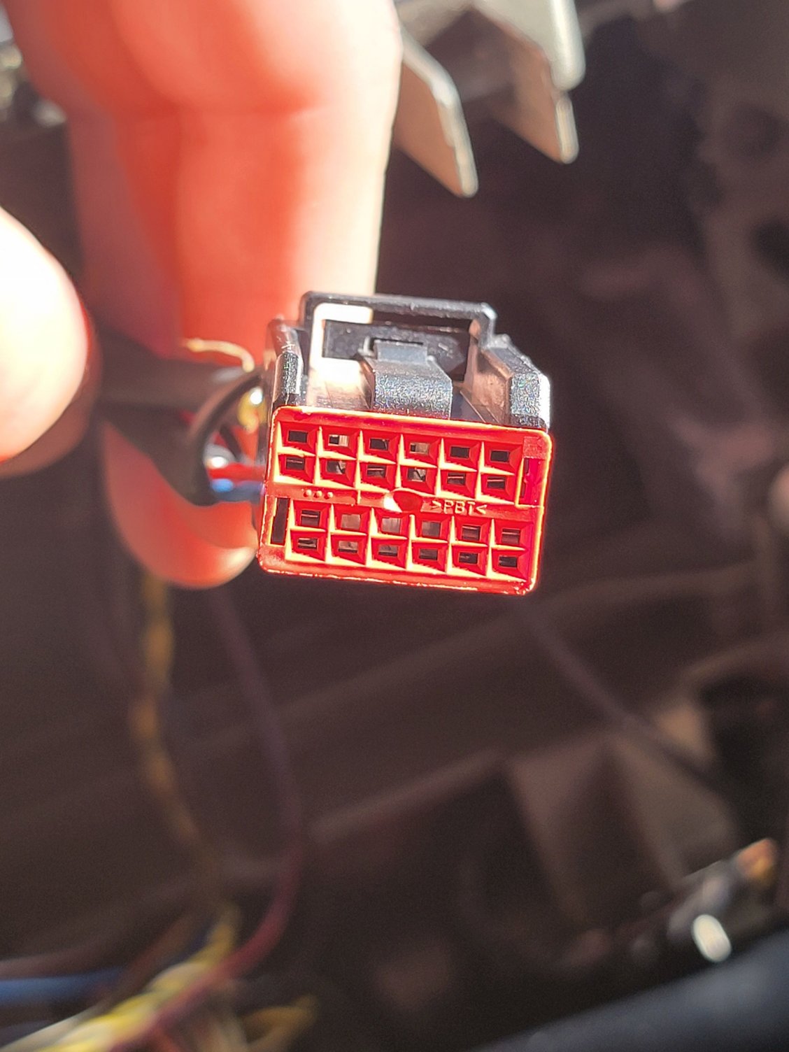

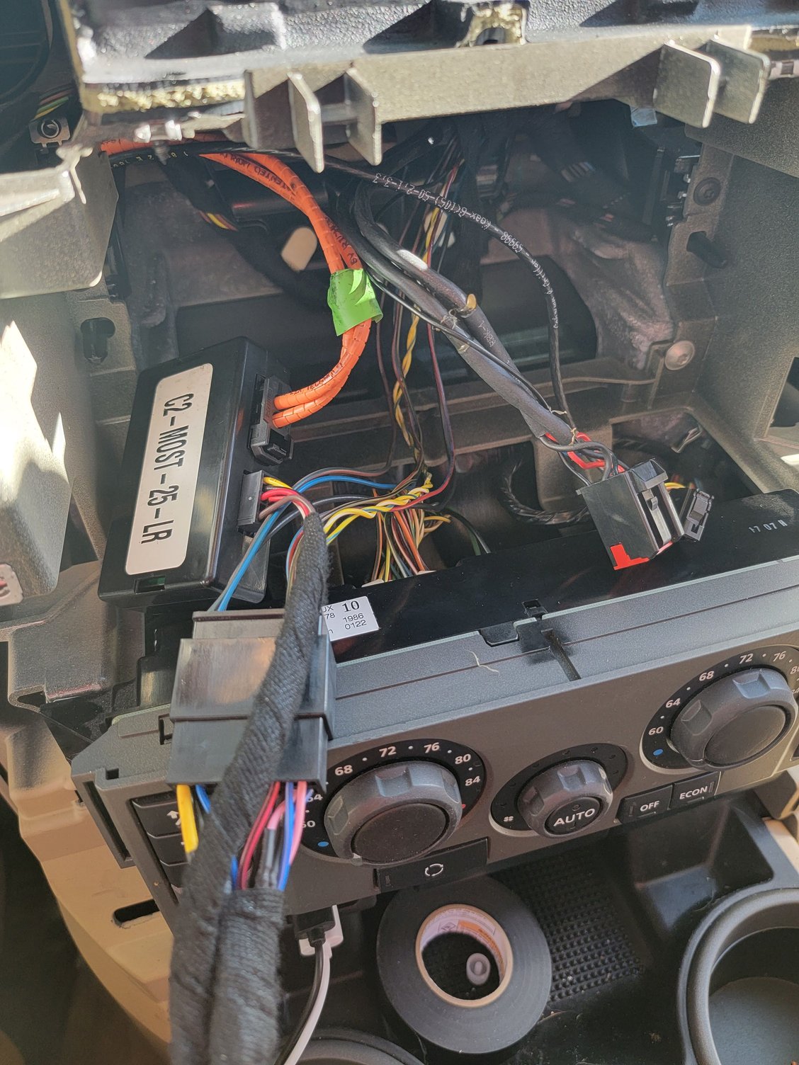

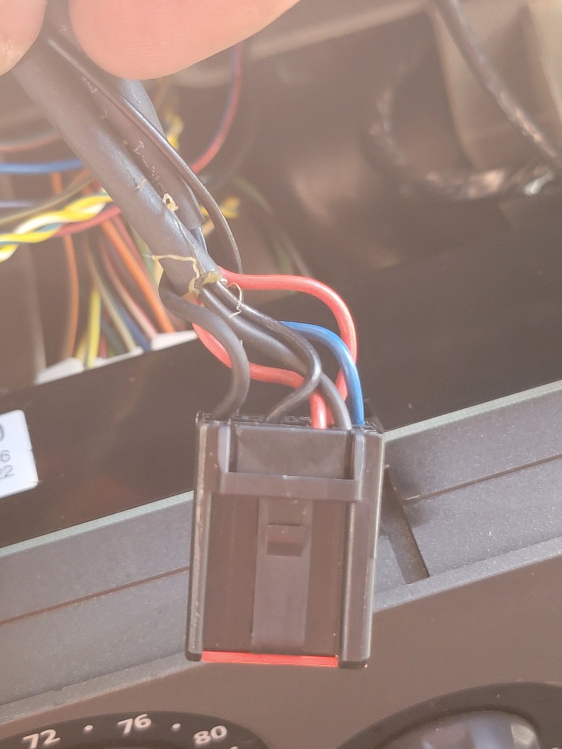

Hello I am currently trying to upgrade my head unit in my 2006 lr3 se. I have the cubby above my stereo no nav screen. I bought the axxess lr90093 harness but one of the harnesses in my stock stereo has no where to plug into. On top of that, when I reinstalled my stock stereo it has no power at all. Can anybody help me out with this?

Aftermarket harness has no socket for the small auxiliary input plug as i also found out which wasn't an issue since i didn't have the factory aux input. I see you have the fibre optic system ( most) so you need to pickup a separate power input for the head unit, piggy back off one the 12V sockets.

Originally Posted by Tyson_wilson
Do you know why my stock stereo won't turn on after I hooked it back up?
Probably needs a reset, sometimes just a lock and unlock of the car will do it.
