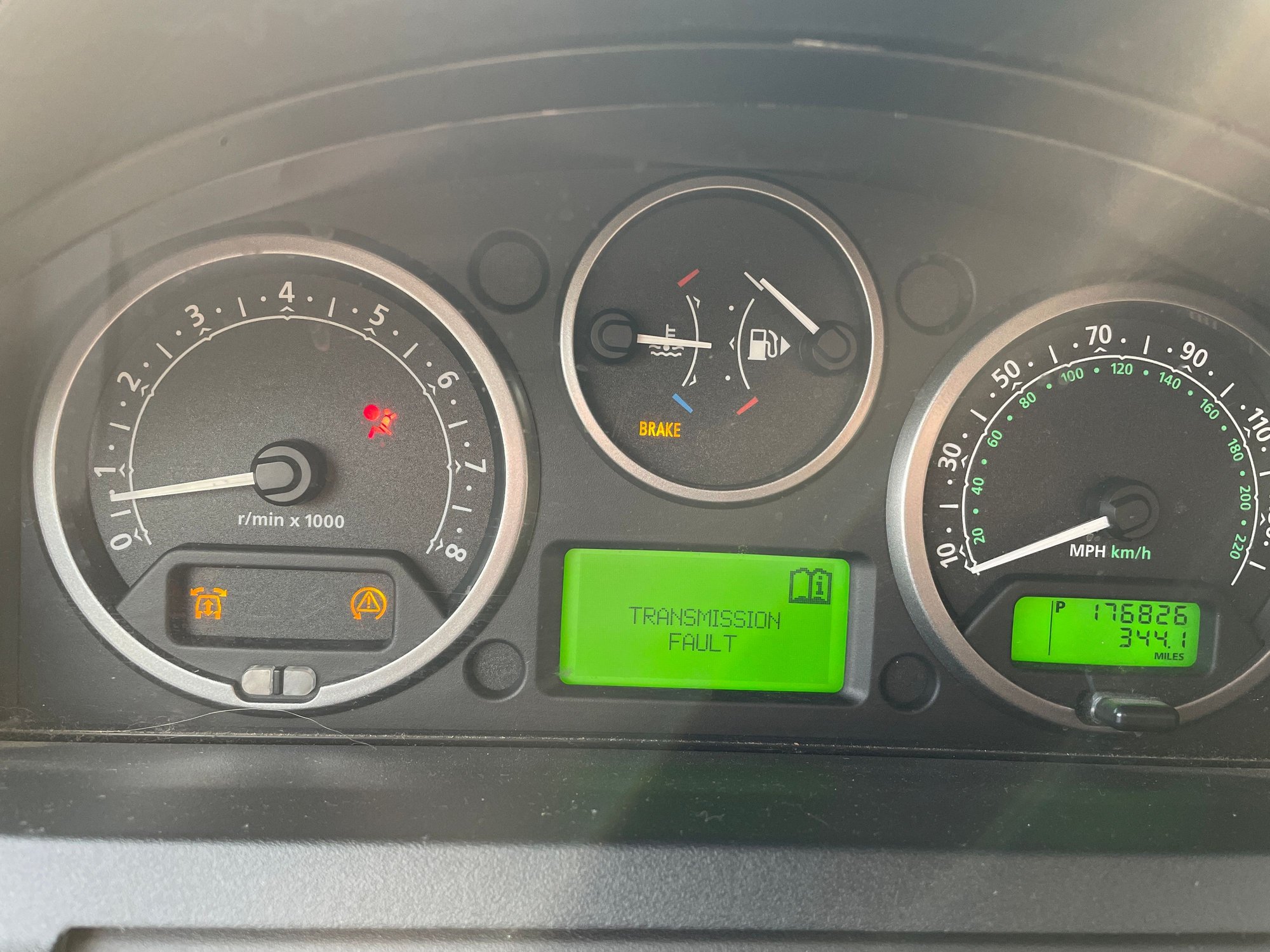

Help needed with dash lights. Electrical?
Old Apr 18, 2023 | 05:57 PM
bigreddawg's Avatar
4th Gear
Joined: Oct 2022
Posts: 4
Default Help needed with dash lights. Electrical?
Additional Symptoms:
I can freely shift in and out if park without depressing the brake.
I can shut off the truck and remove the key without the vehicle being in park.
Suspension is lowered all the time.
Brand new battery.
I have already replaced the brake pedal switch.
Please help!
Thanks!

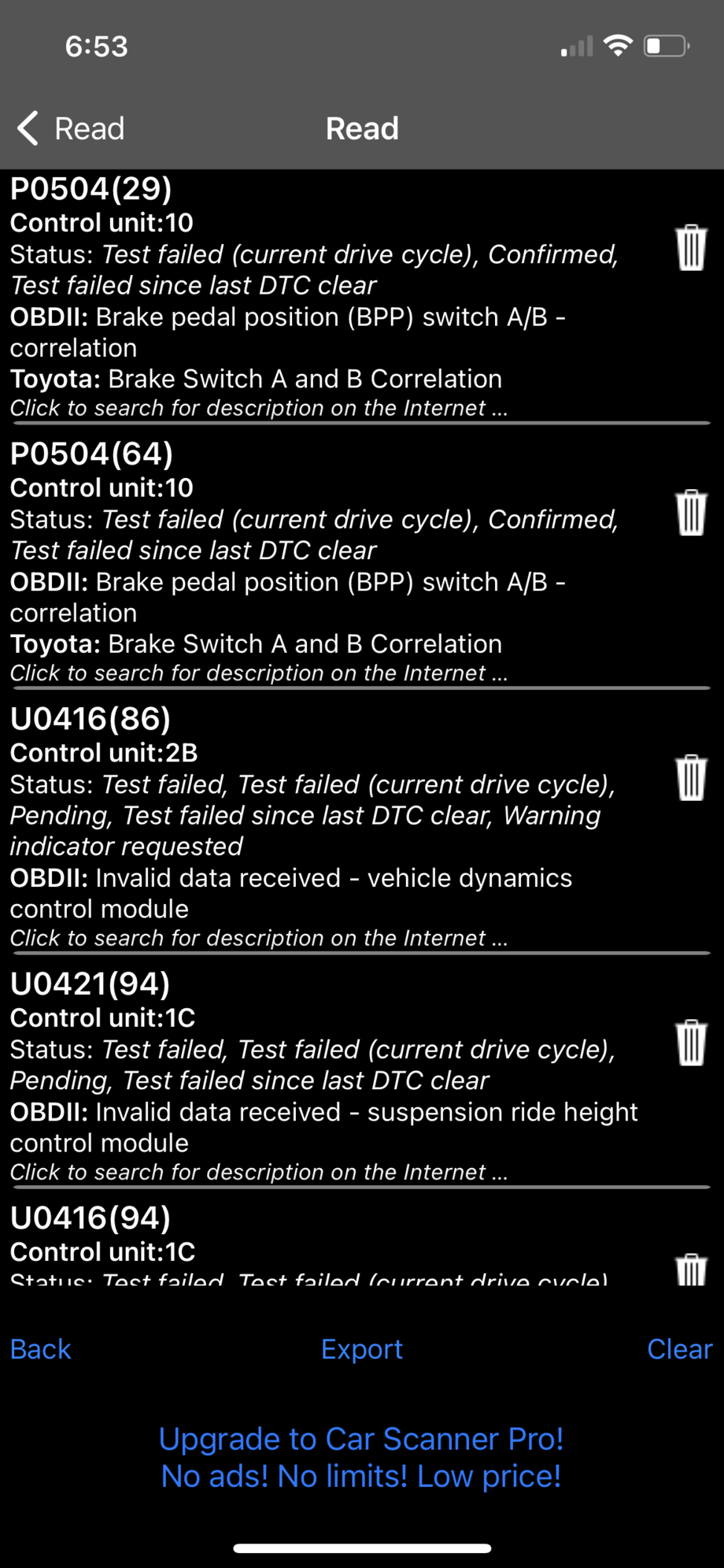

What is operating voltage?
Are you CERTAIN you installed the brake switch correctly? There is a specific procedure, and you can over-twist it on install...
Do you have a code reader?
14.2V
I think that the switch is installed correctly. I also checked the symptoms before reinstalling the switch but after reconnecting the electrical.
I don’t have a LR code reader. The OBD reader spots out several codes see photo.
Old Apr 18, 2023 | 07:20 PM
bigreddawg's Avatar
4th Gear
Joined: Oct 2022
Posts: 4
Also the airbag light tells me it’s not related to the brake switch as this appeared fairly recently compared to the other warnings. Ground issue? Where should I look?
Old Apr 18, 2023 | 08:46 PM
DakotaTravler's Avatar
Joined: Nov 2017
Posts: 4,988
Likes: 962
From: Green Bay, WI
Well your brake switch is messed up somehow.
Airbag crash systems have codes, you need to find the code then can figure it out. Usually those are straight forward. One cause can be disconnecting something, like a seatbelt sensor, they powering the truck up with it disconnected. All airbag codes are hard, which means any fault will trip and keep the light on forever.
