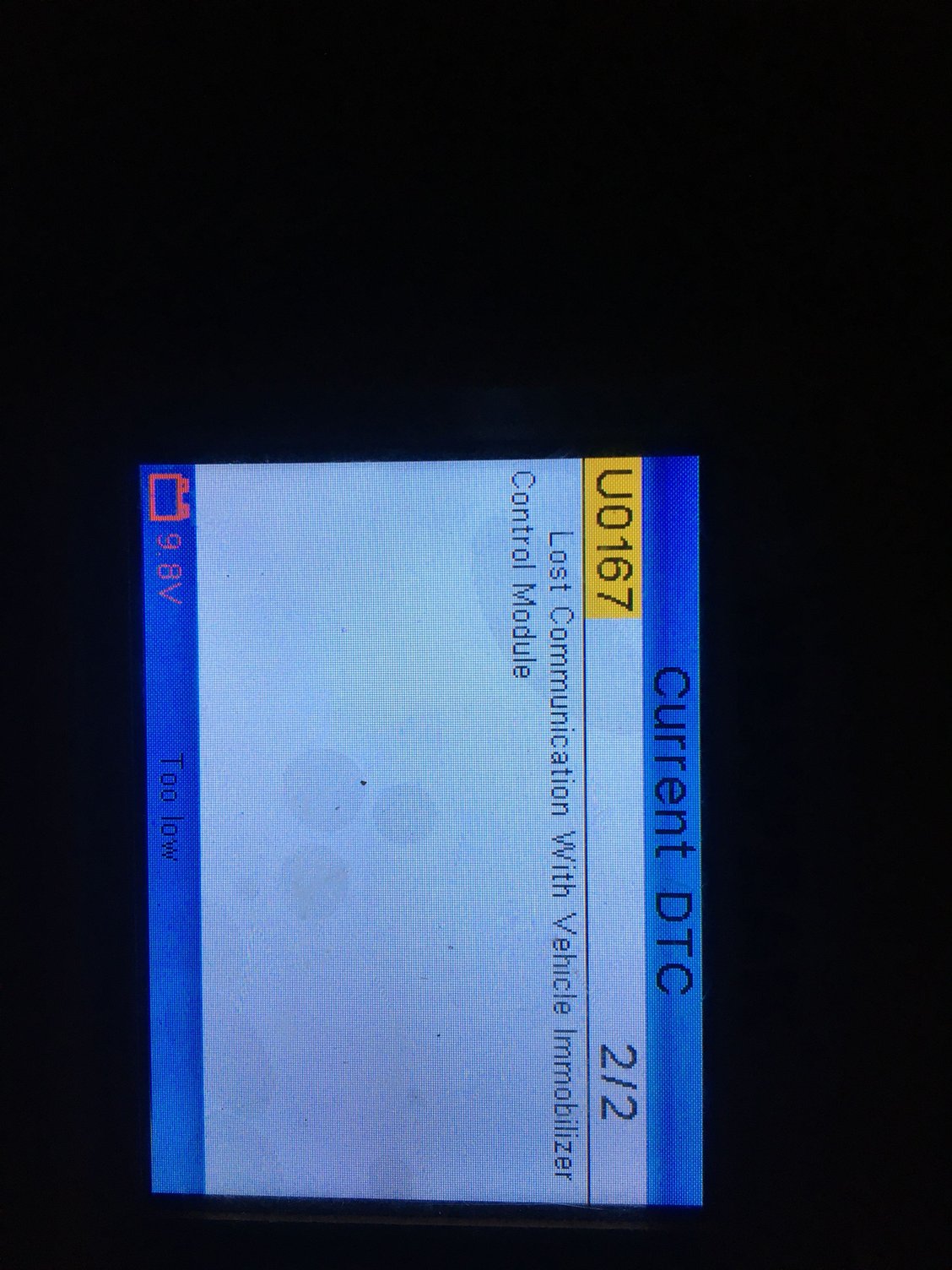

I got this 2 error codes: First one is U0167 and second one is P0622(for this one I think I have to change de alternator).

Your voltage is too low.
May be time for a new battery.

Charge the battery, clear the code, see if it comes back?
