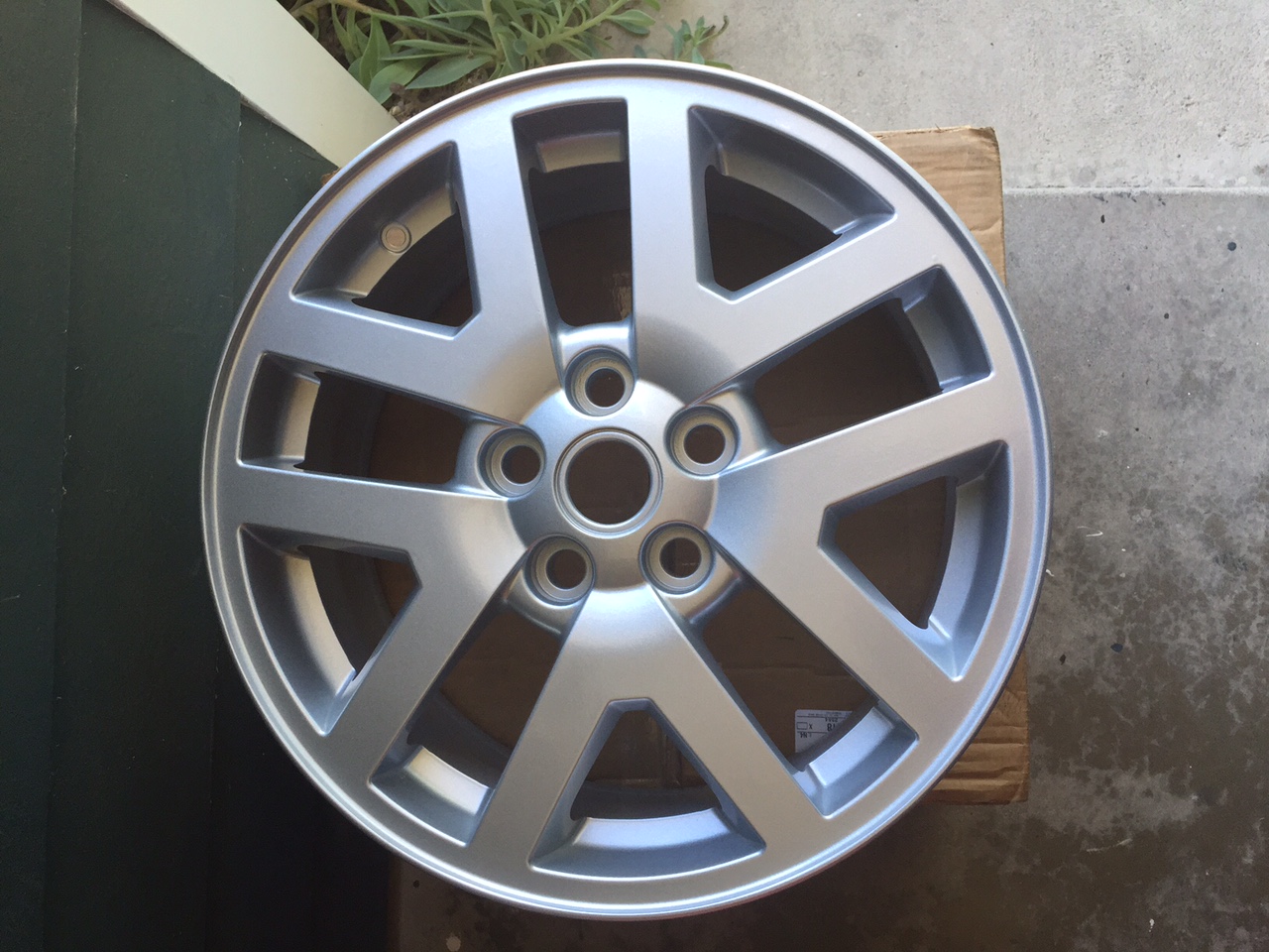

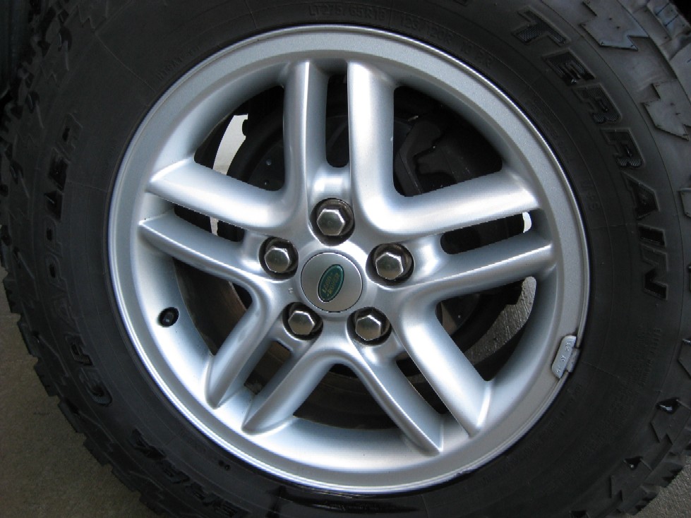

Default Hurricane Byer
The first photo is the D2 hurricane.
Second photo is what I have on my LR3. I've been told they are reminiscent of the Hurricanes, and also been told they are limited edition and hard to find. I was lucky enough to be offered one from a fellow member (Abran) who is parting out a Java Black 3.
Attached Thumbnails Hurricane Wheels on LR3-img_1344small.jpg   Hurricane Wheels on LR3-image1.jpg
