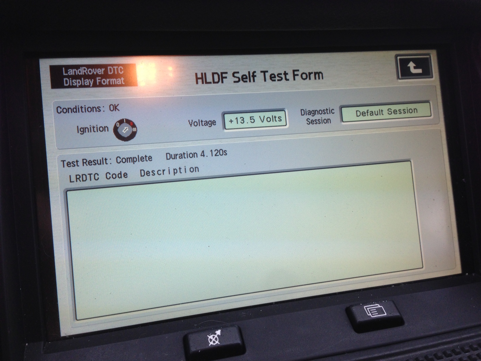

Thanks for the battery advice so I don't fry myself - I appreciate it. But I want to go back to the battery itself for a minute and get some opinions. I've now been to two places who've said the battery is fine, but today I ran the internal system check where you hold your finger to the screen for three seconds, then hold down the left nav-area button for three and it brings up the diagnostic screen. That screen said that when the car is off the battery is at 11.5 volts, and when it's on it's at 13.5. I'll paste in screenshots below. I'm really tempted to just buy a brand new battery and see if that fixes things.
I'm doing things a little bit backwards since I haven't done the hard reset yet -- I got a quote for a new radio head unit today. A Pioneer Avic-6100NEX plus amp plus total re-wiring plus faceplate will be $1900 here in Northern California. I was really excited to do that when I thought it would be about a grand, but double that puts my finger on the pause button.
Thank you all again. Opinions on voltage welcome.

11.5 seems low to me, but these trucks are VERY odd. Were your 'follow me home' lights on? There's lots of electronics that stay active - like the suspension system does a self level when you close the drivers door and get out. Sometimes it's 30 seconds after, sometimes 5 minutes. Last weekend I shut the truck off and I heard a fan of some sort. I thought it was the blower motor but no ventilation was coming from the vents in any way... I thought perhaps the amp under the passenger seat has it's own fan for cooling... I was concerned that I'd find the truck dead when I returned due to whatever it was not shutting off. Whatever it was did eventually stop, as I went back to the truck a few days later and it fired right up. /shrug!
So, if you've had several tests of your battery that all say it's good -- I wouldn't change it unless you want to throw money into the wind. Could a brand new battery be better? Sure, but it's not where I'd focus.
