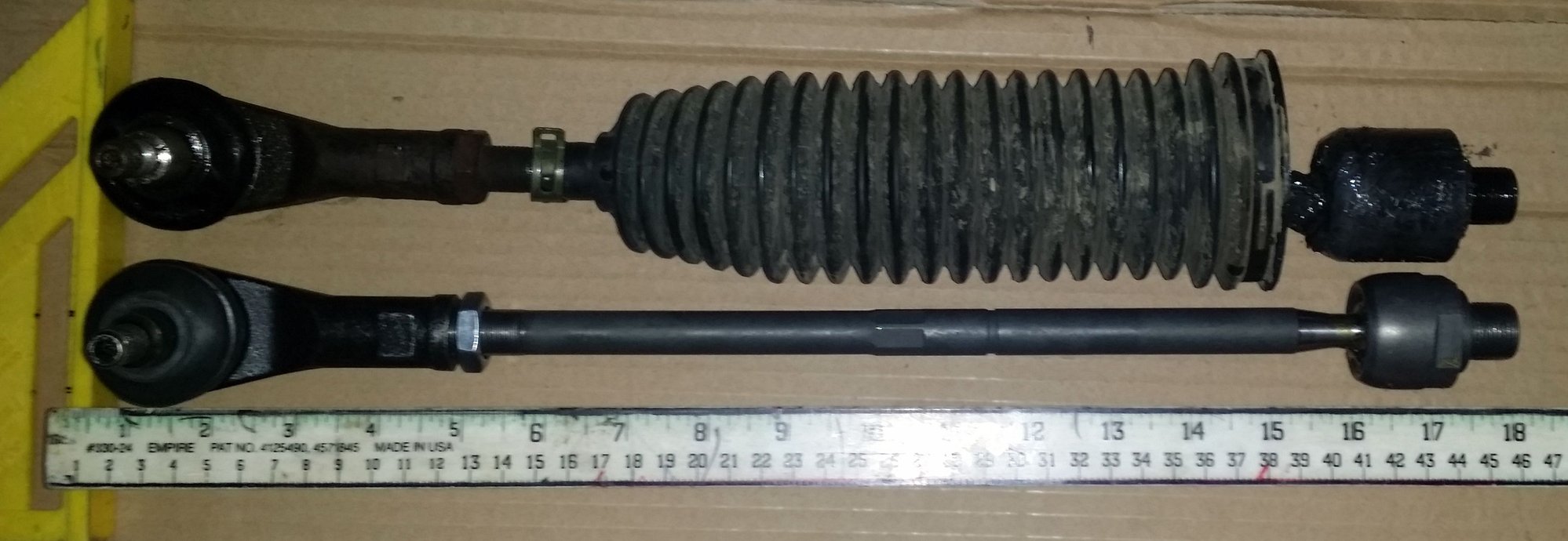

There is a VIN split when it comes to the LR3 and their tie rods. Depending on your VIN you will use LR010667 and LR010668 OR LR010669 and LR010670. These are the whole kits that include the inner, the outer and the boots/grease.
QFK500010 and QFK500020 are identical in length. It is the threaded part on the inner-most end that is different.
This is usually useful information that a reputable Land Rover parts company can provide that Rock Auto neglects to.

Update - I took apart the Passenger (Right) side tonight. The length of the new Inner Tie Rod End (Beck Arnley or OEM - confirmed both are exactly same length yesterday) is approximately 3/16" (inch) longer than the Inner Tie Rod that I removed tonight - The thread on the end that connects to the Outer Tie Rod is about 3/16 of an inch longer. Also, the Ball Joint end of the Inner Tie Rod that I removed from vehicle is larger than the new Beck Arnley / OEM, and is the same size as Ball Joint on Driver (left) side 'old' Inner Tie Rod, that is still on vehicle. I'm posting a couple of pictures. The angles might be a bit off because of camera distance and lens, but it's enough to give you a good idea. The Ball Joints on the new Inner Tie Rod ends look so small, and less durable! Has anyone seen Inner Tie Rods with Ball Joints this size? Anybody know what's going on here? Is there possibly a 'different' Steering Rack fitted? I'm concerned that I won't be able to do a proper alignment when I fit the new Beck Arnley Inner Tie Rod to the Driver side - Too long. This vehicle did have the Warn 9.5 Winch fitted at the factory when new, and also has the HD Package, and also a Mantec aluminum Skid Plate - Is it possible that somehow more durable Steering Rack and Inner Tie Rods were also fitted? Good news - I did a good enough job doing a 'manual' Alignment - No warning or error codes on test drive, no weird noises, car drives straight, and (best news of all) my 'clunks' and brake judder have disappeared. So the 'loose' Inner Tie Rod on Right side was the problem. Fortunately don't need to swap out Lower Control Arms. Anyway, I really want to solve this Tie Rod Mystery, so any help would be appreciated. Thanks, Simon.
