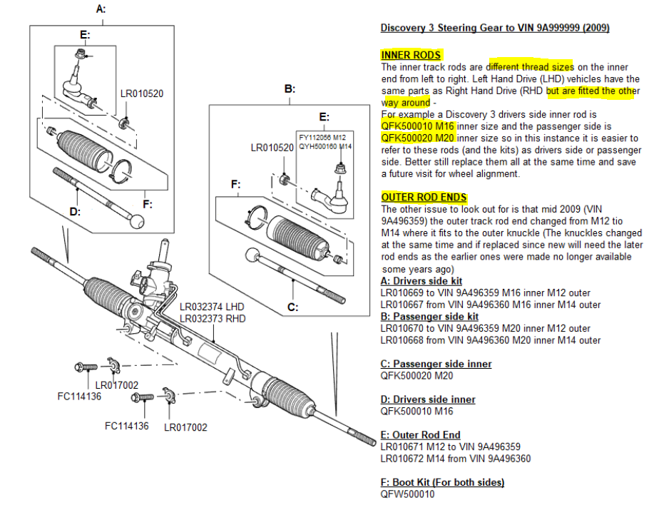

I have LR3 '06 V8 4.4L. I'm replacing the tie rods and bought the tie rod replacement kit from Atlantic British. We just got the parts and pulled out the old tie rods and the inner tie rod doesn't match up with the replacement part. The threaded part is narrower than the part we pulled out, see photo.
Anyone have any ideas? (red is old / green is new)

could it be that the threaded ends of the left and right inner tie rods are not identical? one is smaller than the other?
This is correct, different thread size on each side.

I face palmed really hard on this one. At least you figured it out. But I am going to note one thing for future reads, care must be taken when ordering outer tie rod ends as they can be year specific since there was a change in 2009 and it is possible, by now, that entire knuckles could have been swapped due to an accident. Say like putting a 2011 knuckle in a 2007.
