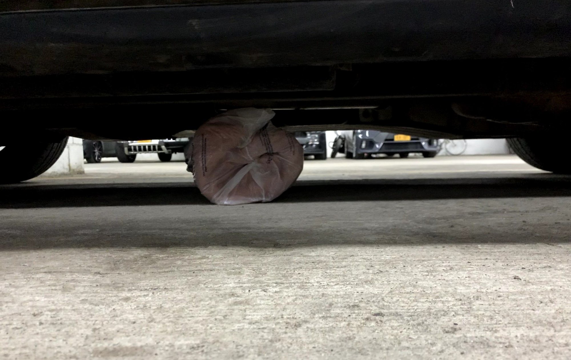

A couple of days ago, I was thinking what would happen if I trick the system in relation to an obstacle below the LR3 that gave me the message "SUSPENSION IN EXTENDED MODE" and "RESET SUSPENSION HEIGHT IF CLEAR OF OBSTACLE".
I have put rolled moving blanket (I keep in my trunk) under the car, and lowered the car to access height. I get only icon that car is lowered and no other message. The
"‎SUSPENSION IN EXTENDED MODE" message is gone since then. ‎
‎Just today, again lowered the car, then lifted the car to standard height and lifted the car again then lowered the car to standard height and no issue. ‎
