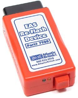

I have a LR3 that has had the coil spring conversion kit from Atlantic British installed. The original owner did not include the orange box and plug that I would need to wire in permanently to shut off the red air suspension fault light. If anyone has one and would like to sell it, please PM me. They are not in stock right now and I would like to get that light shut off. Thanks!

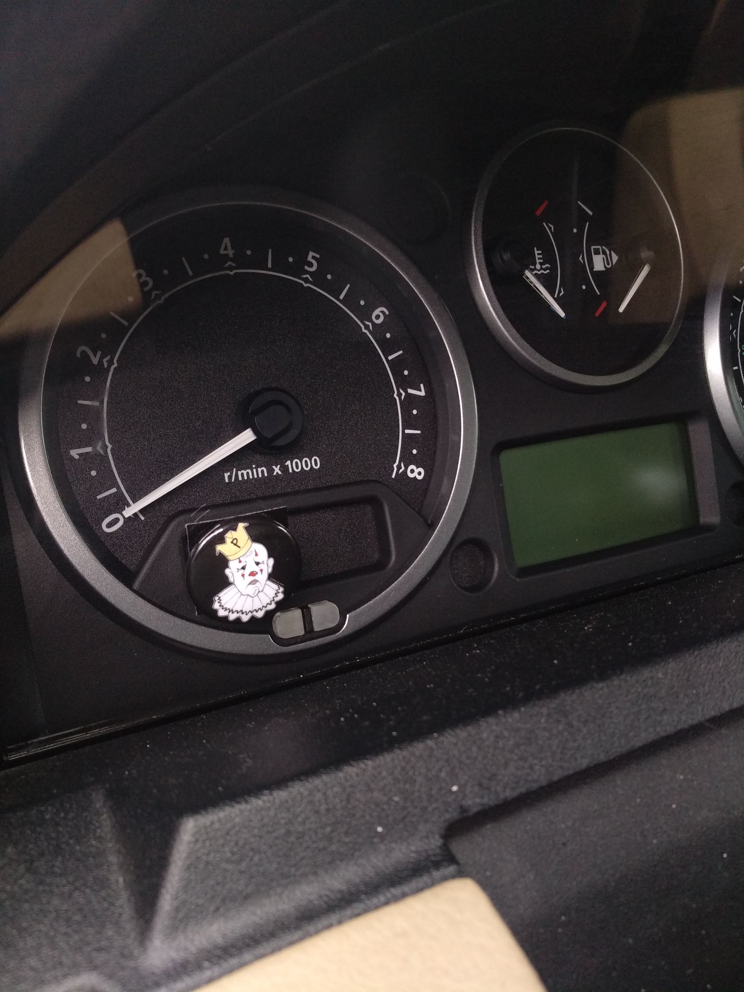

After contacting the original owner, the installing shop, Dunlop UK who promised to send one to a shop in the US who both quit replying to emails, I came up with this high tech solution for getting rid of the red warning light.

This worked for me!

Unit is back in stock and AB will sell the device for ($300 less than the entire kit new), so I am doing all I can to avoid this. I bought a 09 with the kit AB from a LR dealer in Houston, who did not include the unit.That said, I have not had anyone confirm what features actually are not operating without this module once the conversion has been done, thus far I have not noticed features not working beyond the obvious of not having airbag suspension. AB is not willing to go down that rabbit hole with me to discuss all the possible shortfalls of not having the flash unit, but it sure would be helpful prior to shelling out what is essentially new kit money.

Terrain Response will not work.

I'm actually in the same boat here...had my brakes done, shop didn't know what they were doing, and "unflashed" the programming. Just got off the phone with Atlantic British...they sell the device for about $550. Ugh...
Would love to buy one from anyone who has it. I'd also be willing to sell it to another forum member as I only need it once.
