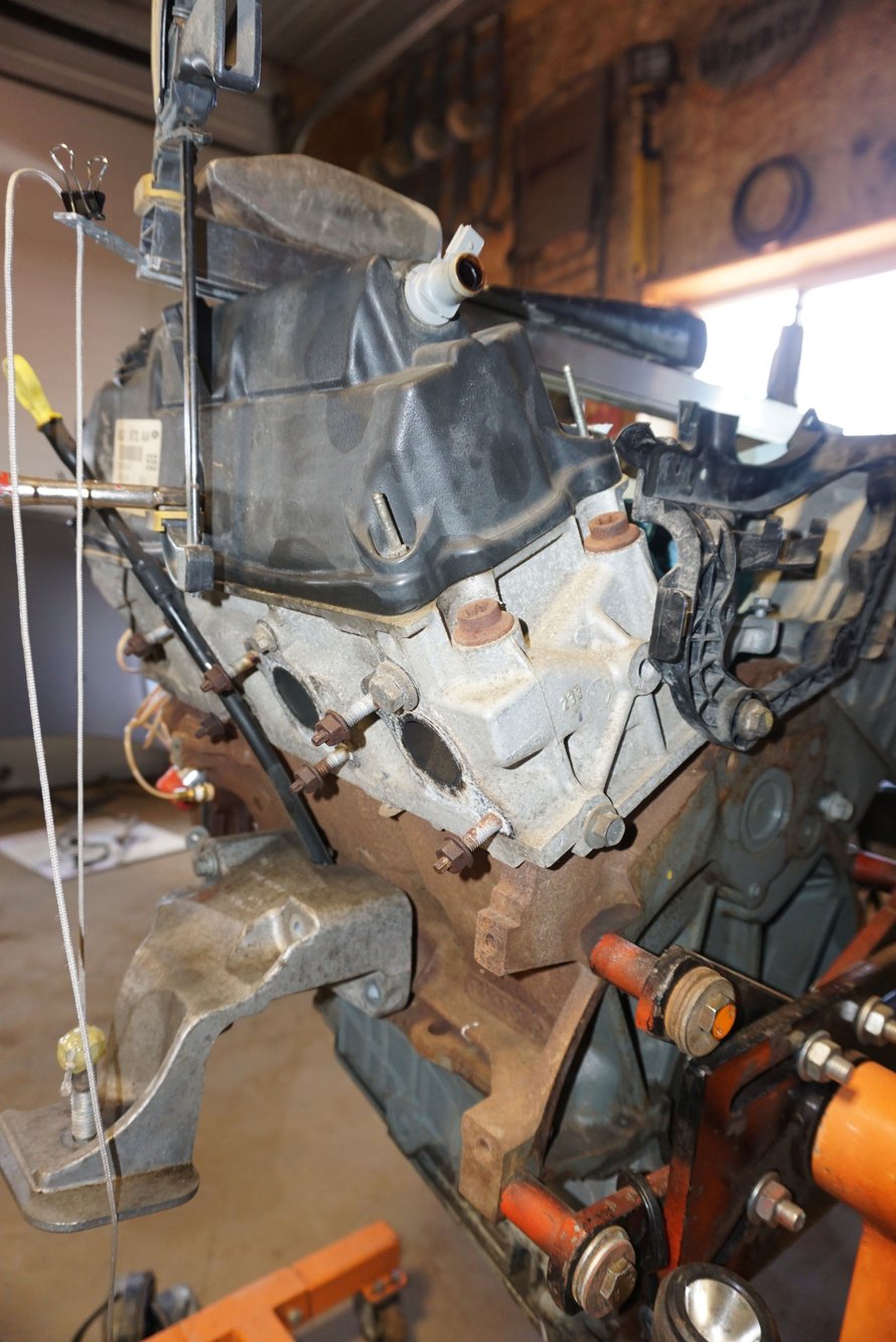

July 16 and serious issues with Ranger engine install are related to engine block motor mount points (different), we are putting together a solution but it likely won't be pretty...

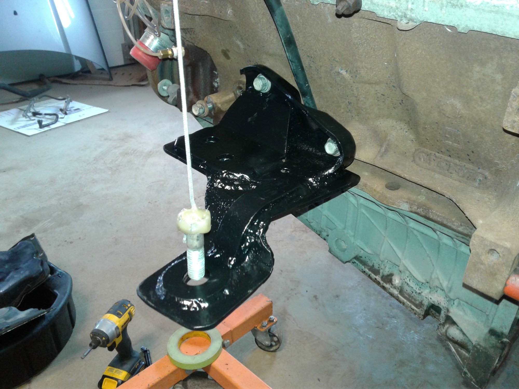

Building a new motor mount for the Ranger engine (driver's side North America), will post photos within a few days. Apparently Ford produced engine blocks that had different external threaded and tapped ports for whatever reasons, but I'm sure we'll persevere and chive on. Sample attached...

Forgot to add photo of the completed Ford Ranger to LR3 engine mount adapter...
