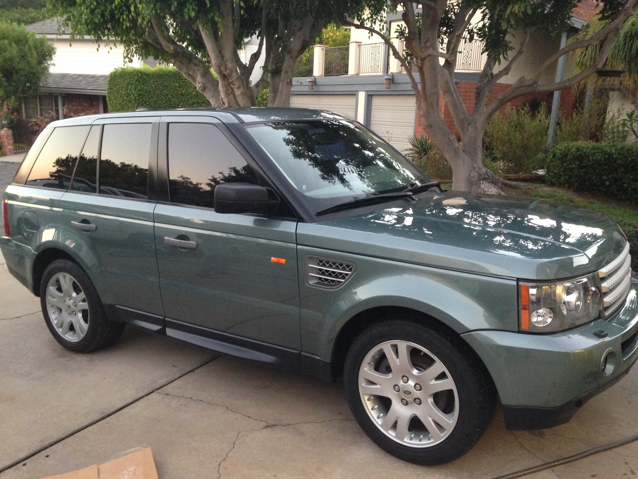

I came across this old thread. Thought that I would post a photo or two of the finished project. I still have a couple of minor issues to sort. Front sensor issue and an adaptive headlight fault. Looks like a ground issue. Blend door motor needs replacement. Waiting for a new one. Truck runs great. I have put about 5,000 miles on it. Phil

Looks great

Awesome.
Honestly thought it wasn't going to end well. You did a good job.
