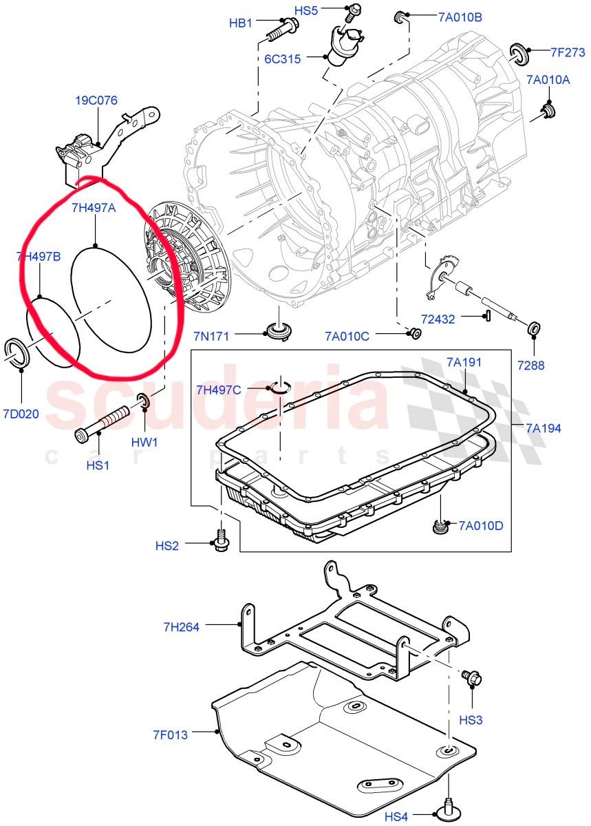

Looking for the front pump stator O-ring, # TYX500020 / 7H497A .

Ford 6R transmission should be the same. It's a ZF 6HP26 that is licensed by ZF for Ford to manufacture. Many transmission supply houses on the internet that can supply that for you instead of going directly to Land Rover. Note that not EVERY (typically exterior controls, brackets, etc) part on a LR 6HP26 is interchangeable, but those should be.
