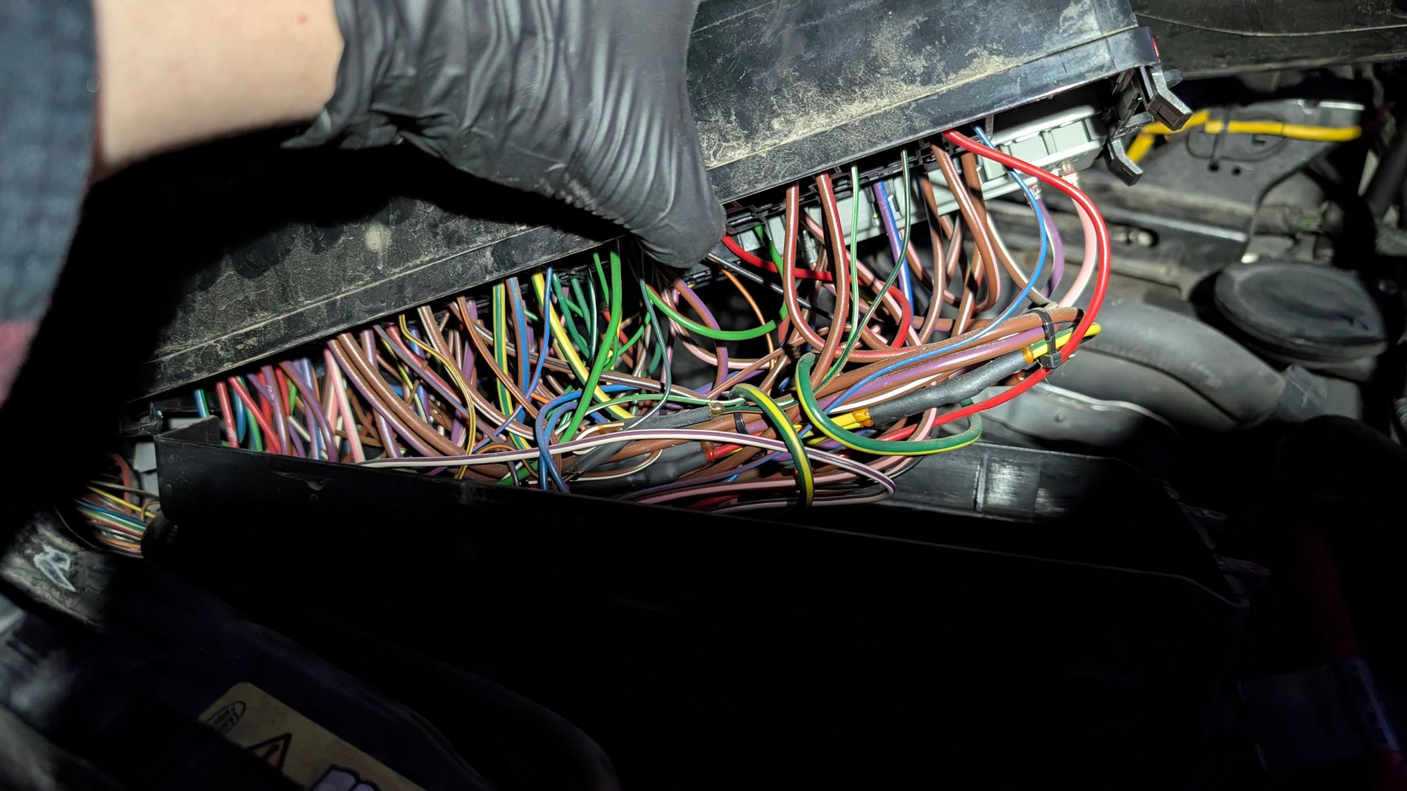

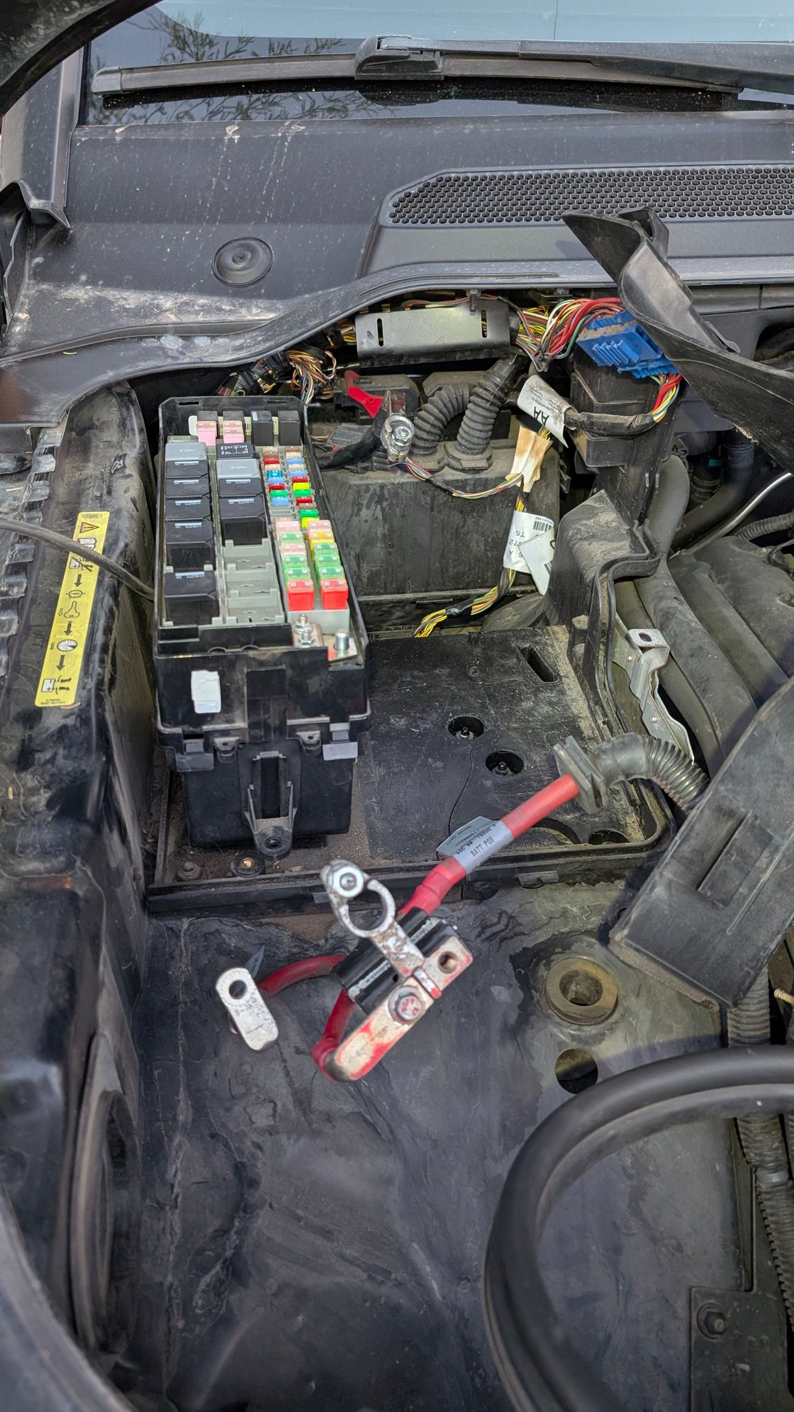

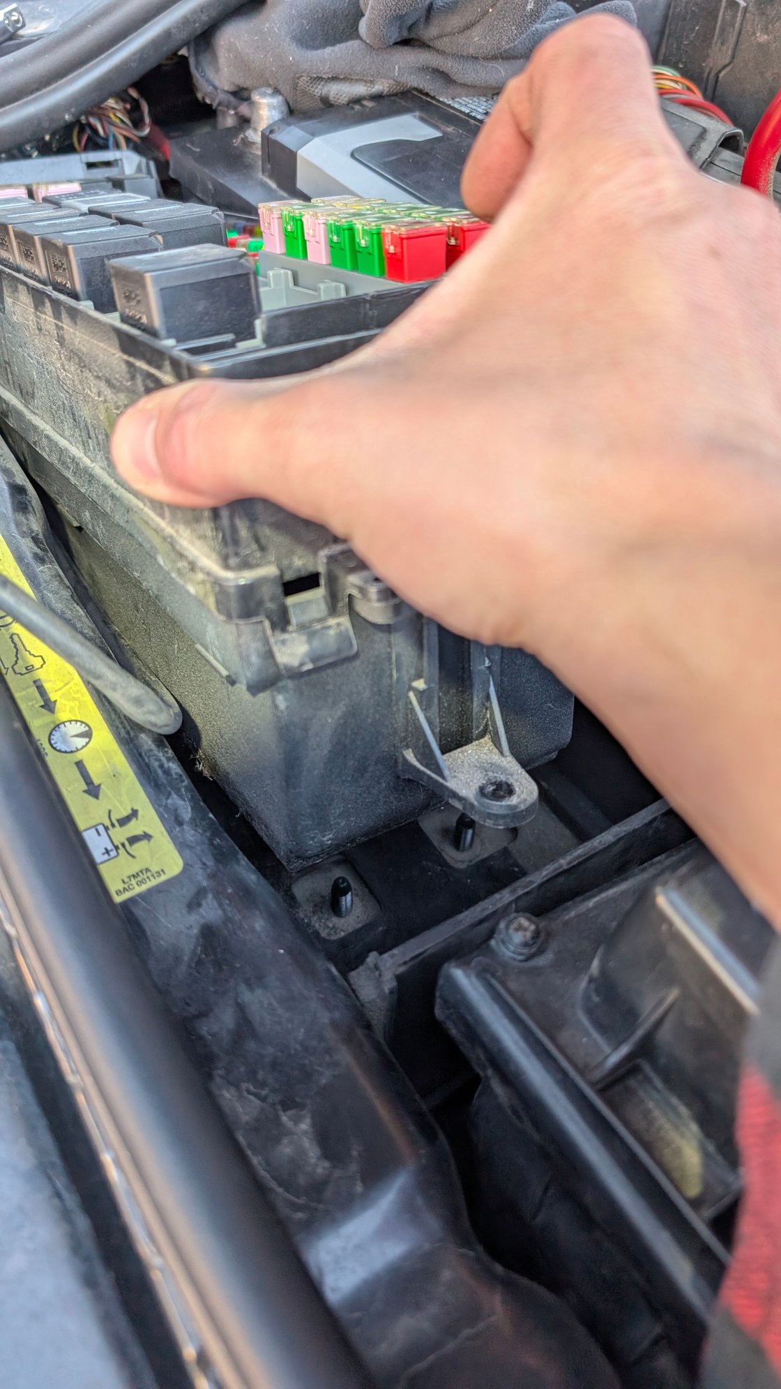

For anyone else that needs to get access inside of this fuse box (battery junction box) always disconnect the battery first. To give yourself as much room as possible, remove the battery, the air box and the plastic divider around the battery compartment. There's one 13mm bolt holding the junction box in place. There's also a positive connection from the battery that needs to be undone from the junction box. 8 believe it was a 13mm or 15mm bolt. Once you remove this, you can lift up the junction box off of some threaded studs. To open the junction box, Carefully push the tabs on the front while lifting up on the latches. I jammed a plastic trim tool into the gap to help separate the two haves while pushing up on the latches.
There are two latches I the back of the junction box too, but they are very hard to get your hands on them to undo. Luckily just getting the front latches undone was enough to gain access to the inside of the junction box
Junction box lifted off studa
Battery and air box removed eofor extra working space

Spade connectors on underside of junction box going to relays
